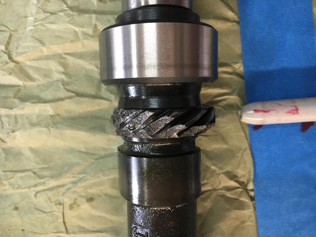

The Distributor seized, the Camshaft lost some teeth. The Driven Gear on the Distributor is a tough, little brute! I have a few questions beyond the remove/ replace steps spelled out in the manual.

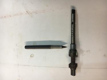

Here is a photo of the mangled Camshaft and the Distributor Shaft bound to what seems to be a housing part pressed into Distributor bodyAttachment 6442Attachment 6443
Im planning to flood the damage area, try and flush the shrapnel into the pan, pull the pan.
I’m also thinking of pulling the cap off the Distributor every other oil change and flooding the area with a thin lubricant. I don’t know how uncommon this failure is.

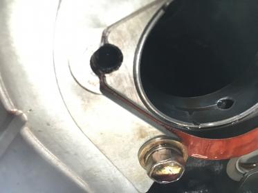

Check out the firsts cam bearing.
Attachment 6444
It looks damaged and the marks don’t look very fresh.

Thanks for the reply Tim. If you examine the photo of the Distributor shaft, where the pen is pointing, you can see a part that I think should be part of the housing. Maybe pressed in? That part is bound to the shaft.
I think this experiment (disaster) shows that the pin in the Distributor shaft might not shear if the shaft binds. However, my Distributor was rebuilt, and the pin was not original. Maybe the original pin would shear. My camshaft lost most of its teeth in the ring.

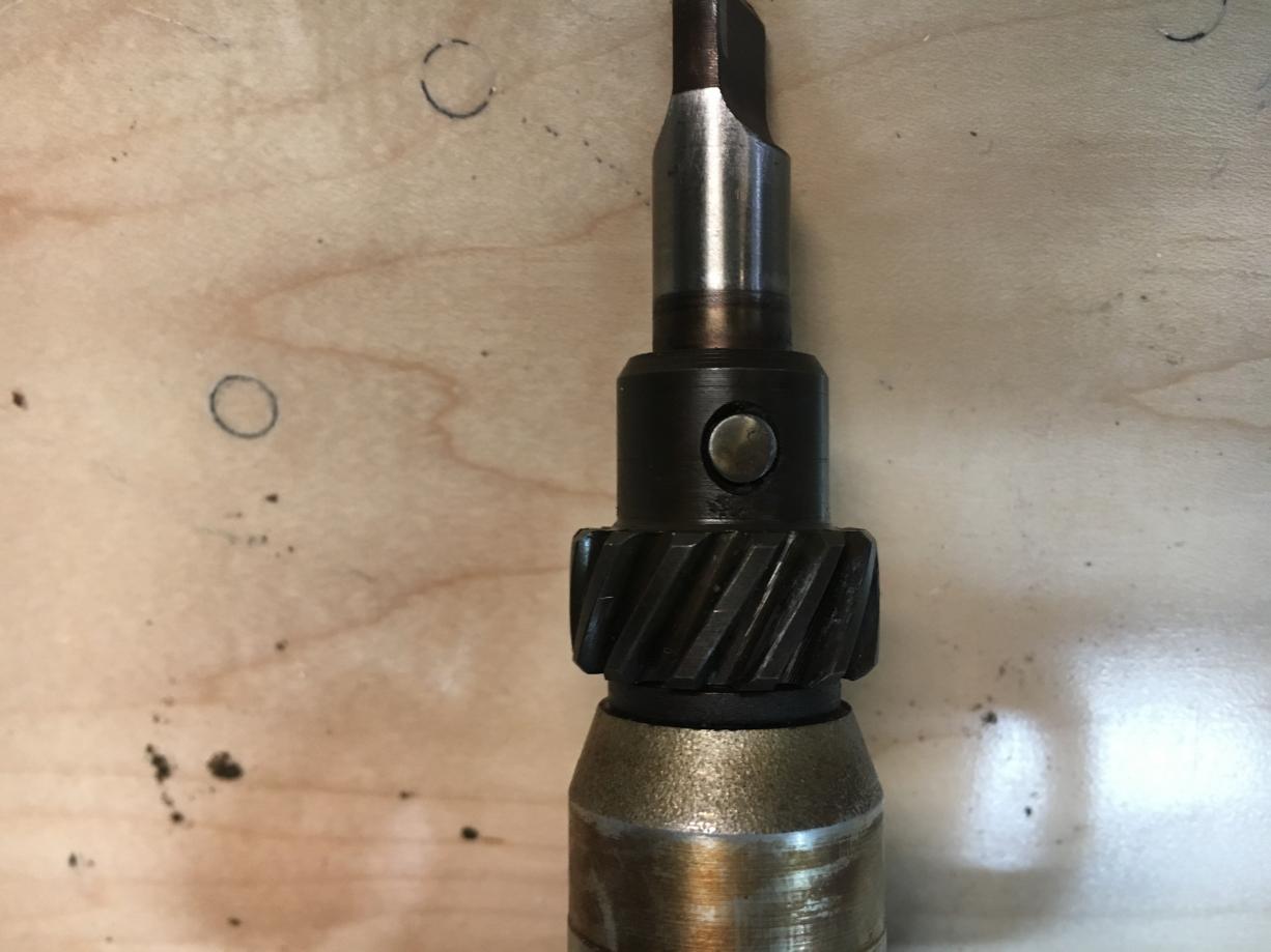

What I would watch out for: My Distributor was rebuilt. It had a different pin in the gear. Maybe the original would have sheared before wrecking the Camshaft.
Here is a photo of the stock Straight Pin.
Attachment 6499
The pin looks the same on both ends
