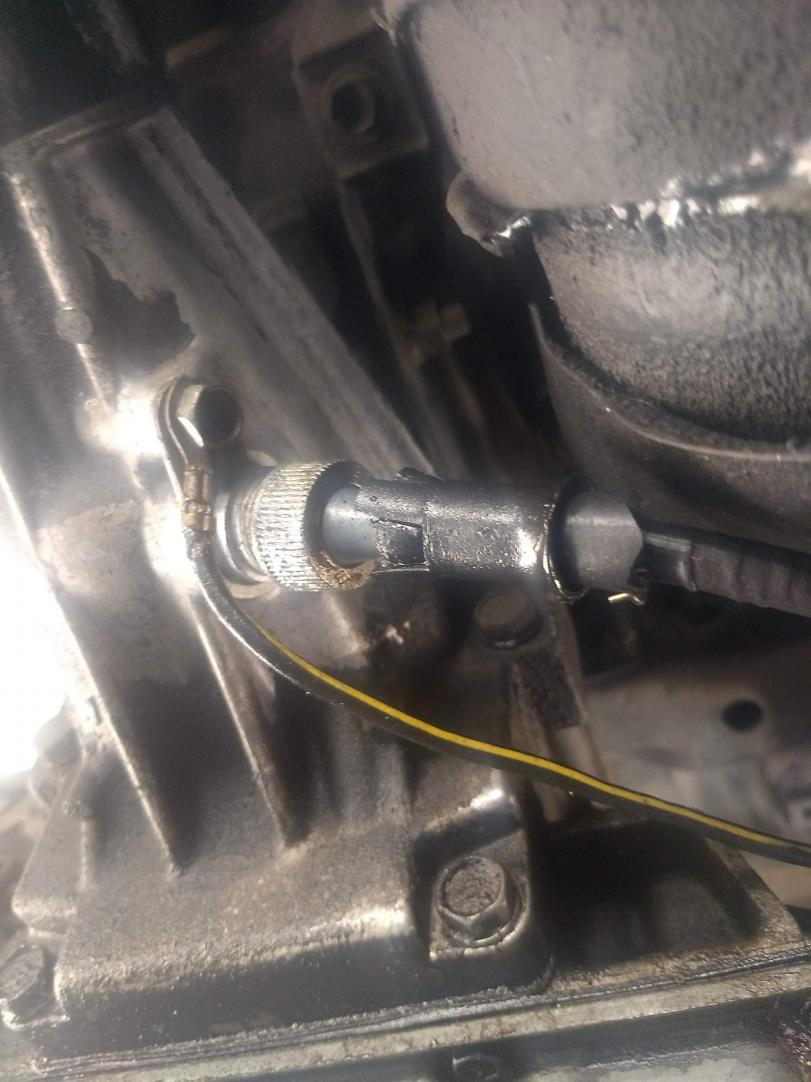

Ok, so having gone through this myself recently (and I FINALLY figured it out lol), here is the transmission end you're going to want to find:

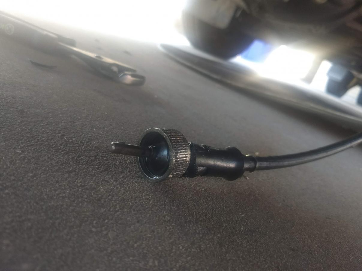

Once you get that piece off, you can simply pull out the cable:

By chance, what transmission and drivetrain style (2wd/4wd) van do you have? I learned the hard way there is a lot of variation in these parts given the varying lengths between the gauge cluster and back of the transmission. I should still have a good cable for an manual 2wd van if that's what you have, I also have the speedo cable for a 4wd automatic van. I know there is a difference in length between automatic and manual van speedo cables, I'm not sure if 4wd or 2wd makes a difference though. If you're willing to be a Guinea Pig, send me a PM.
