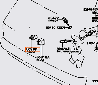

Check out EFI relay (PIC) If ck engine is NOT lit and links are GOOD (tested) and ground is good then check relay. Locate it and when key is turned on it will click. I doubt computer is fried

Just checked out toyodiy and seems to be some big fuses in there as well on my 1986. Any/all could be blown due to battery issue.
I am extrapolating TLC methodology to van but i doubt it is all that different
| 85910F |
RELAY, COMPUTER (FOR EFI) |
| 90987-02004 |
1 |
$45.07 |
Attachment 7287
