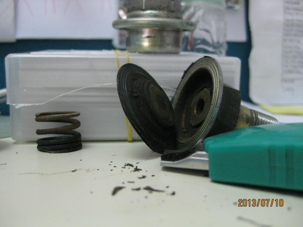

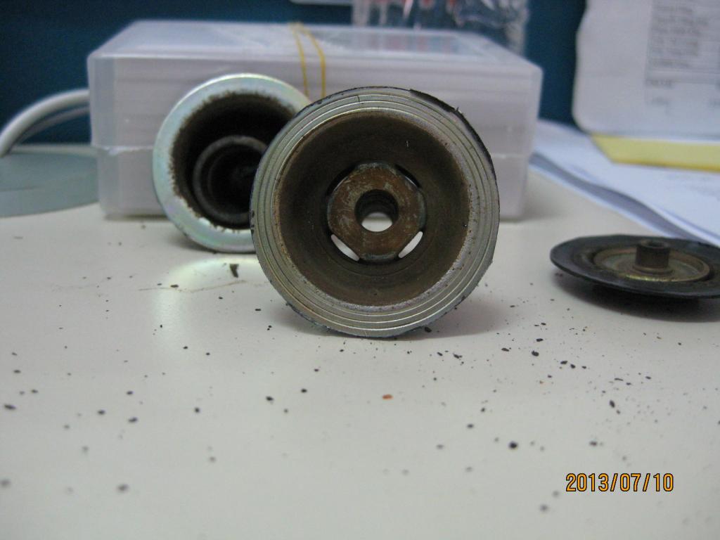

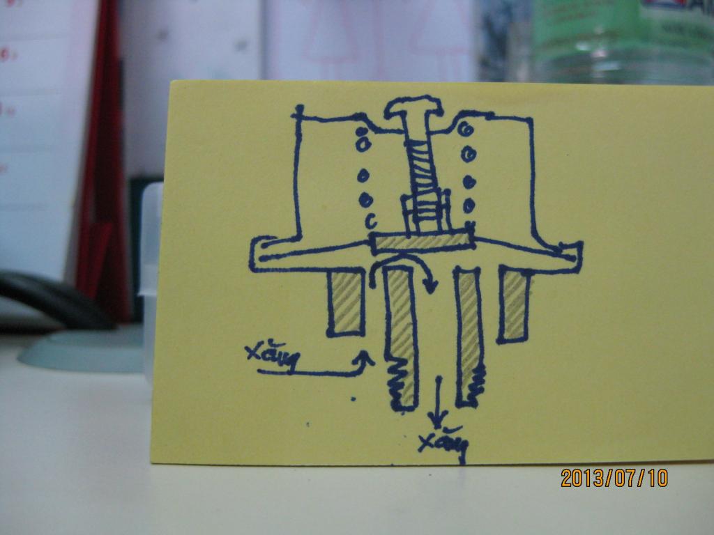

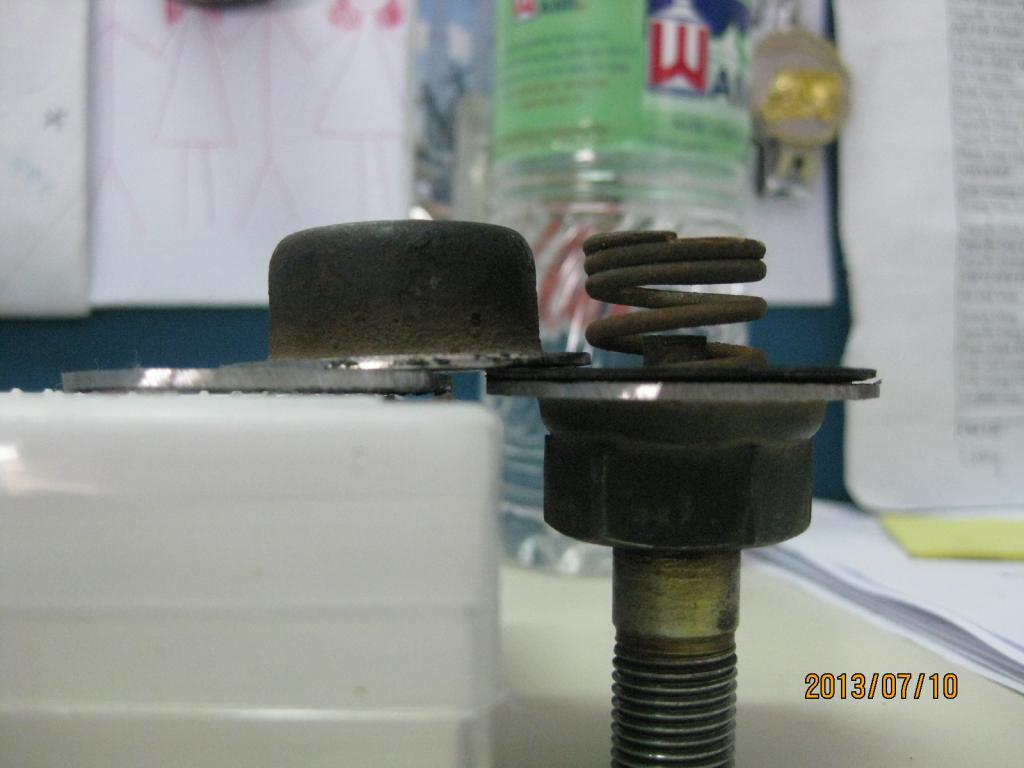

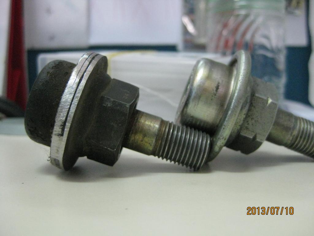

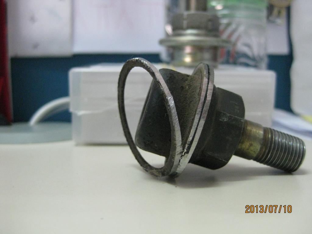

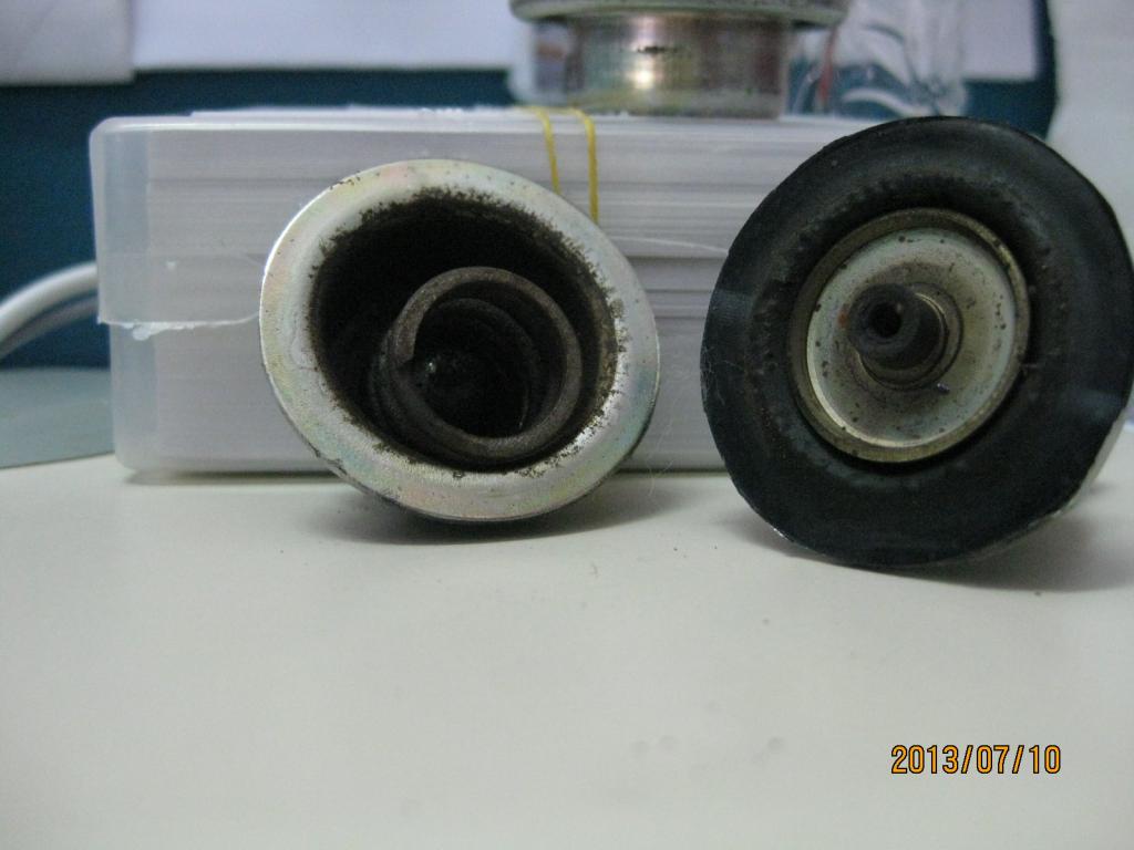

Dear All, I have some pictures about damper:
Attachment 1030 Attachment 1031 Attachment 1031 Attachment 1032 Attachment 1033 Attachment 1034Attachment 1035 Attachment 1036
These pictures made by Mr. ToyotaVan85 - an owner's Van 1985, he love his car very much. I am his friend!!
Nice pics. Thanks for sharing. :thmbup: More information on he FPD HERE
