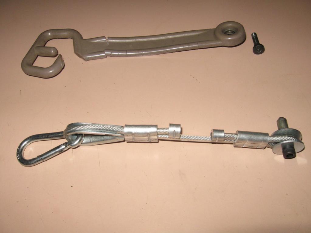

where can i find a replacement for this hood holder plastic catch, whats it called ? are there any pics of a home made one?

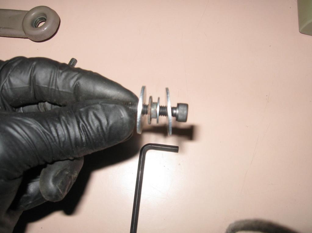

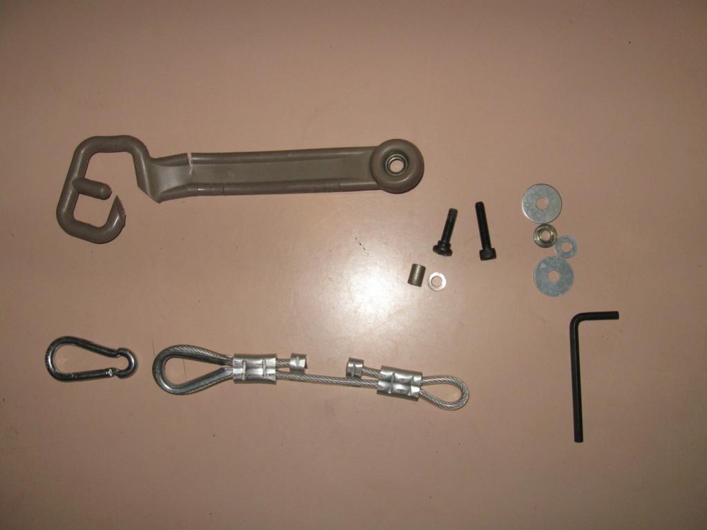

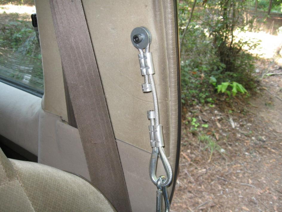

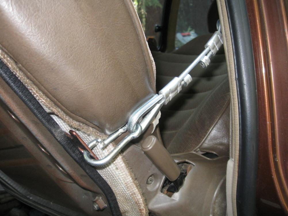

Again, thanks to the post that Tim provided above for the inspiration. In case it's useful my version is shown in the pictures below. The whole cost was less than ten dollars and took an hour. The cable is 3/16" vinyl-coated steel cable, with a 3/16" thimble on the bottom, and a stack of big/small/small/big washers on a slightly longer bolt than the original. In high load cable assemblies you should not use those aluminum ferrules on plastic-coated cable, but for this application they grip well enough for me.
Attachment 1909 Attachment 1910 Attachment 1911 Attachment 1912 Attachment 1913
I used plastic coated cable so it wouldn't snag on things or abrade the interior fabric. You could use uncoated cable and wrap it in tape or attach a little fabric tube to enclose it. I'm sure there are good ways to make a hood holder with 1" web strap, too.

The "correct" (Toyota) name is ENGINE SERVICE HOLE COVER SUPPORT BAND and the part number varies by color:
58936-28010-03 GRAY
58936-28010-04 LIGHT BLUE
58936-28010-06 LIGHT BROWN
All of which is immaterial because, yes, they have been NLA for a looooong time. The member-made versions are all much sturdier anyway, and the importance of that aspect becomes apparent the first time an OEM fails with your head in the engine bay ... :swear:

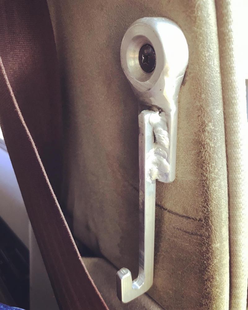

You know that plastic hook you use to hold up the seat so you can work on the motor?
Mine broke.
I made a replacement in aluminum.
Attachment 10232
Attachment 10233
