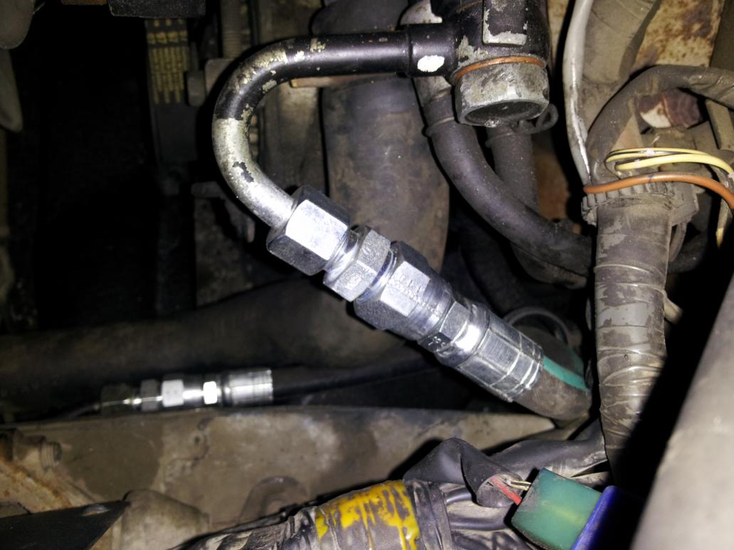

I recently bought an '88 2WD LE Auto, and soon discovered a leak in the power steering high pressure line. The general area was easy to spot, on the rubber hose near the banjo connector to the pump, but somewhere under the extra insulation on the hose. It gushed pink froth from the top of the insulation when you turned the wheels. I never had a high pressure line leak before and was surprised... this van only has 125k on it.

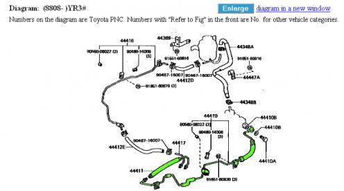

Attachment 86

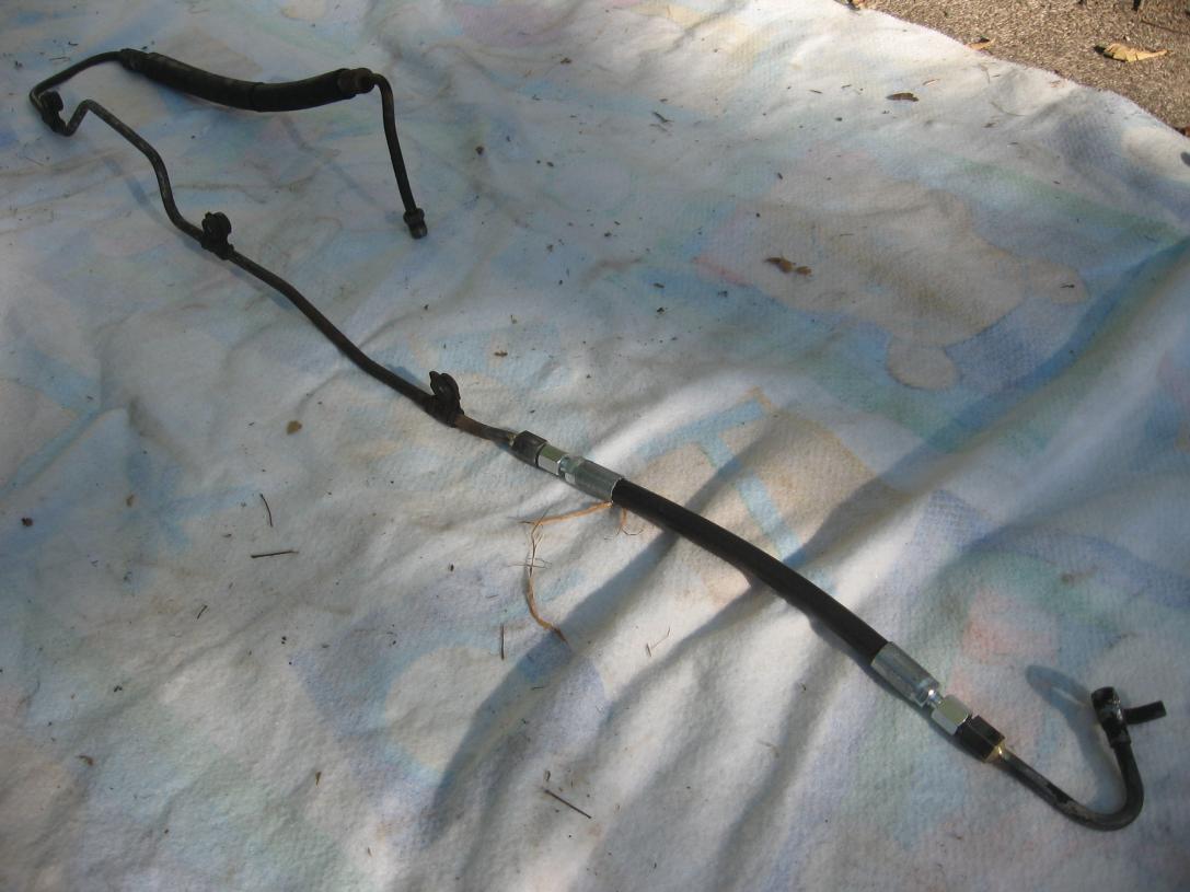

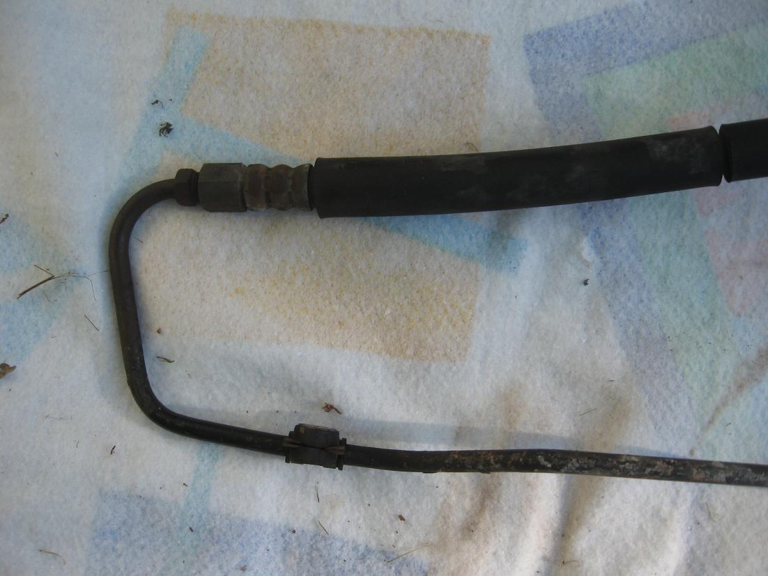

Unfortunately, I didn't think about taking pictures until the job was almost done. The Toyota diagram will have to do as the before pic. It shows the pump end of the line as hose that is crimped to the metal line and not easily replaced. The other end of the line has an easily replaceable hose with fittings.
As I sometimes do, I took it to a reputable shop that I deal with. It is a national franchise and offers freebie service checks. I have spent little to no money with them in the years that I have been dealing with them and they have always gone over and above to tighten a clamp or point out a leak to me a no charge. I always tell them that next time I'll spend some money with them next time.
They found a replacement line for me from Toyota and quoted me over $500 for the job. I need to find the quote but I think it was $300+ for the line and $200+ for the labor.
Attachment 89

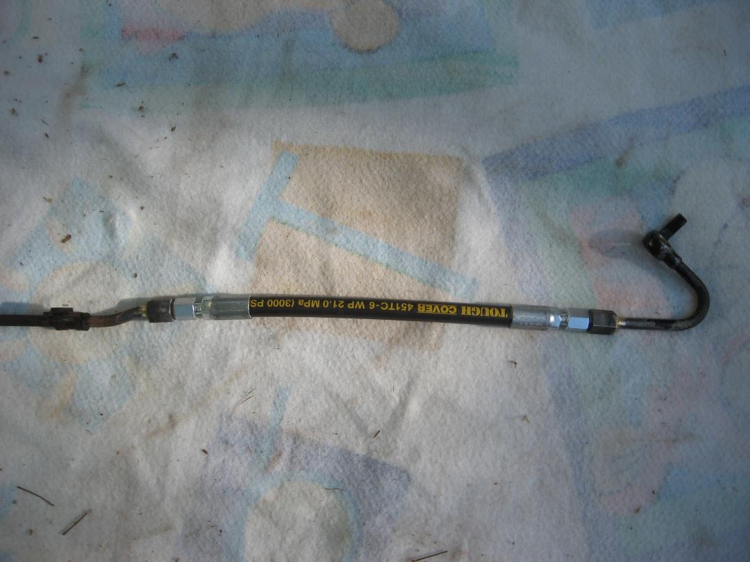

I ended up removing the line myself and taking it to a shop that specializes in hydraulic lines. There are a couple of things wrong with the above pic. The mounting clips are all above the line itself. In reality they need to be turned 180 degrees and point "down" for mounting. The second problem is that when the shop added the extra steel of the crimps and unions I gained rigidity and lost the flexibility of the rubber hose that was replaced. The line as it was in the above pic was impossible to install. I had to take it back to the shop, have them cut more tube from the banjo fitting end and re-braze.

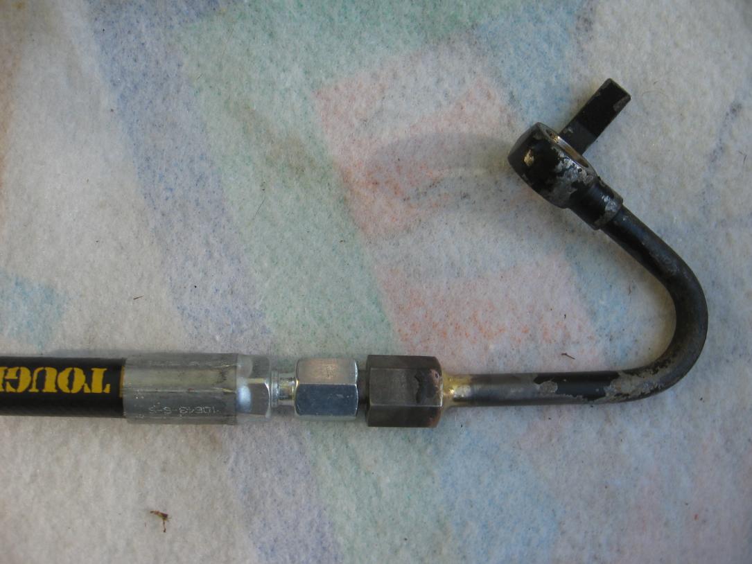

Attachment 88
This is the pic of the line after it was shortened and re-brazed. Note the connector is almost up to the curve in the line now. One problem since the length was changed was that the hose no longer fits back in the retainer clip. It is hard to see in the pic but it doesn't touch anywhere along the frame. The metal ferrule on the hose likewise doesn't touch the lower radiator hose, but they are both something I will check after driving it awhile.
If I were to do it over, I would go find a cheaper off the shelf hose that would fit as close to perfect as possible. I would then cut the line (this was the easiest way to remove it) and clearly mark where the brazing should be done and not leave so much to the "experts" to decide.

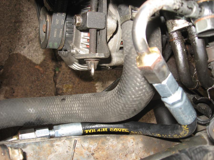

A few other pics:
Attachment 84
A closer view of the new hose, crimping, unions and brazing. All in all they did a good job.

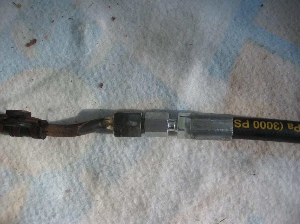

Attachment 87
A closer view of the connection to the line.
Attachment 85
A closer view of the banjo end... before it was re-sized.

I did this job in a driveway... no lift. I did not pull the radiator or the transmission cooler. I did remove the lower mount screws of the cooler and pull it forward a little. It gets wedged on the mounts and gives you enough room. I did cut the line to make it easier to remove. It was going to be cut anyway.
This was an exercise in patience and things that weren't going well one day went a lot easier the next day.

Yes, cut it right where the small diameter steel line ends and the flex line begins. I actually used a sawzall because I wanted to save as much steel line as possible. Of course a sawzall will leave burrs and get some grit in the line. Some fluid will leak out but this is good in a way as it will carry some of the grit from the cut out with it. After it quit dripping I carefully deburred the line, then I used Q-tips to drag out the junk that was left inside. I left the long steel line installed when I replaced the flex hose part. The steel part of the line is pretty embedded so it saved a bit of time. I took the banjo end off the pump and modified that end on the bench. I went ahead and got an extra hose and set of adapters so I could also do my 4wd van. There's other ways to do this (as you can see from dogfish's post), but this way works well & doesn't require welding or complete line removal. To save the hydraulic guy the time you may want to print these pics and take to him along with the old flex hose (after you cut it off) for length reasons. Here is a picture of everything you'll need to do the job. Tim
