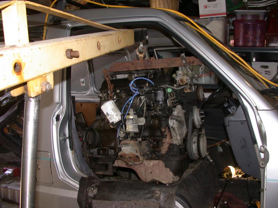

I figured this would be a good place to document yotamog's engine swap so I'm posting some pics of it coming out of my parts van. I took the passenger side door off the van, rigged the chain/hook on my cherry picker to the lowest setting & set the chain up on the engine with very little slack. Here it is before lifting:

I knew it was going to be a tight squeeze, but wasn't sure just how tight until I got to the door opening:
http://i8.photobucket.com/albums/a23...v/IMG_0187.jpg

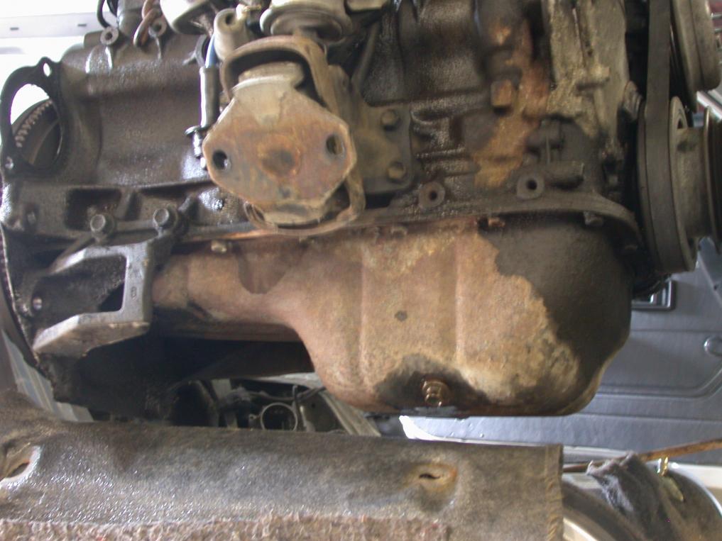

Check it out.......close-ups of the top & bottom of the door frame :)>::
http://i8.photobucket.com/albums/a23...v/IMG_0188.jpg
http://i8.photobucket.com/albums/a23...v/IMG_0189.jpg
It came right out without any contact with the van body :clap::

Yeikes! That was a close shave. Guess that's the way mine is gonna go too. The van repair manual says to lift 3 feet, mmmmKay...

I would only lift the van just so you have access enough to crawl under there to remove stuff, then use a cherry picker through the passenger door like I did. Unless you have a hoist/rack, picking the van up 4' isn't practical. Good luck and keep us posted. Tim

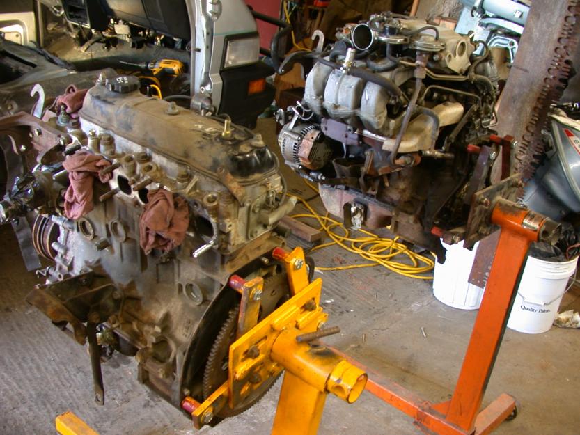

Using a similar setup as Tim, you can see the hook attached without any chain links to the arm of the hoist.

With minimum clearance over the valve cover by the chain, like you said Tim, there was at least an inch above and below the engine on the way out the door. E-Z squee-Z.

Now I have them lined up (borrowed stands) and swapping parts will continue tomorrow. I thought about just plugging the end of that cooler line on back of the head as you suggested, Tim, instead I went for the quick swap- glad I did because there is no gasket on that plate and the sealant on the replacement motor was iffy. No more "hose of death port" worries for me.
Attachment 342
