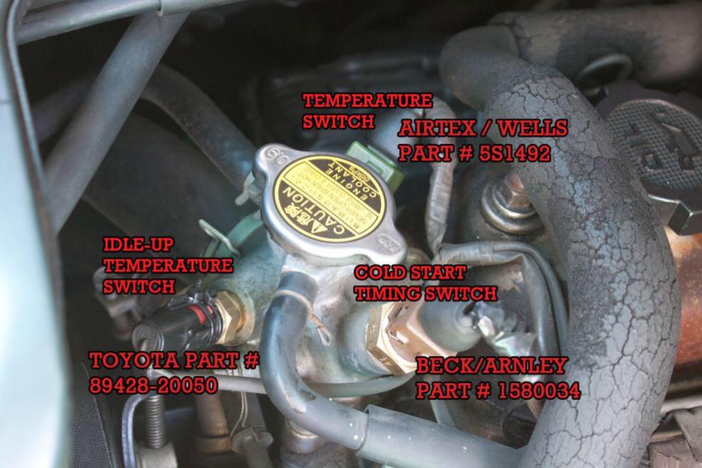

Attachment 6556
try grounding whats labeled as the idle up temperature switch wire and see if that helps..
its not advisiable to ad cool water to a hot engine.
