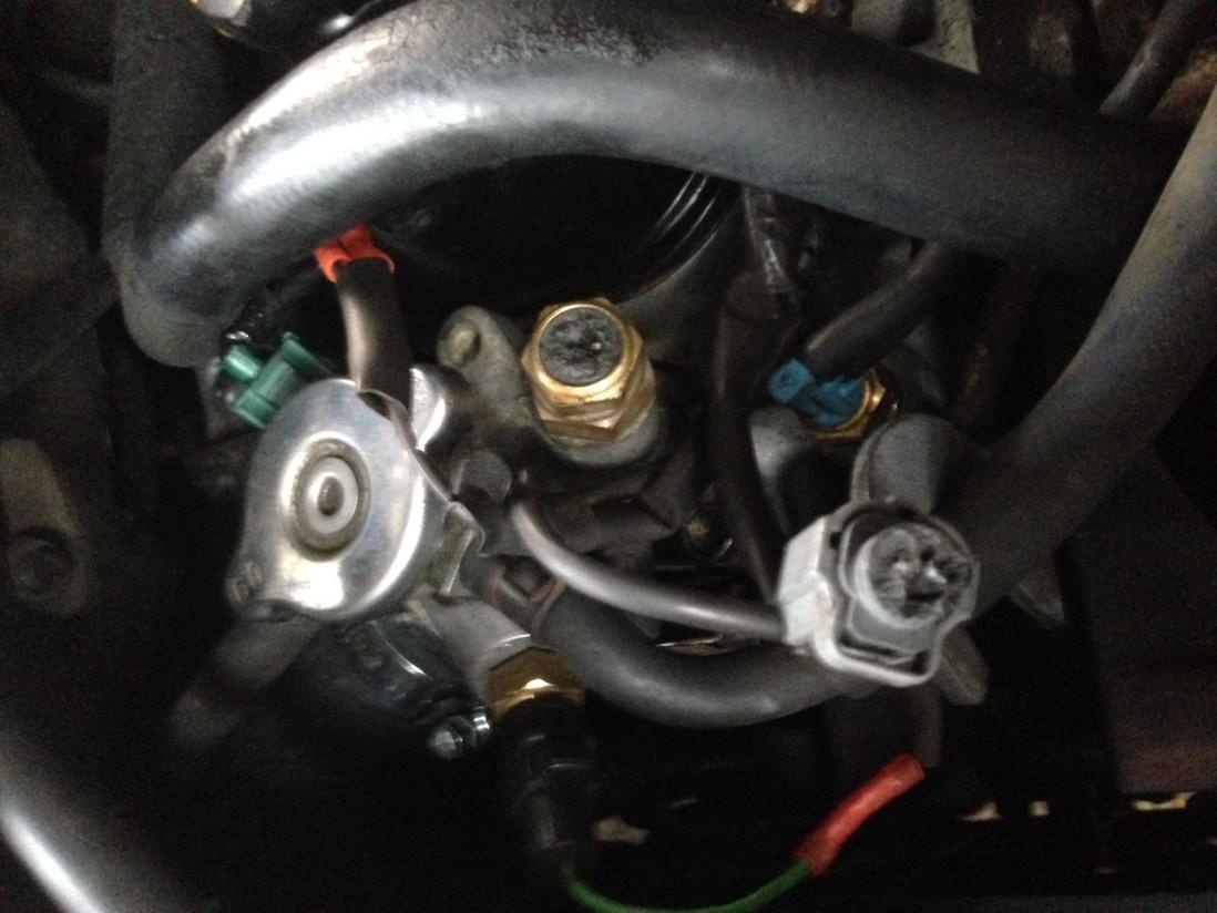

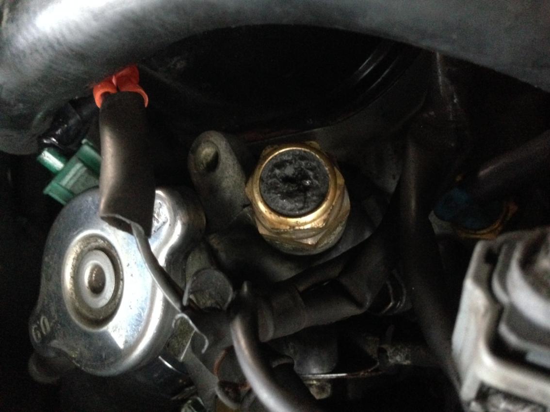

Hey Folks - Driving home from school last night and my van stopped responding to gas, then died. I managed to get it home, but it can't idle for long before shutting off. Smells like weird gas mixture. Not sure if this is related, but also makes a thumping noise when wheel is turned hard to the right. Even in park. Opened her up and found this obvious problem in the attached picture. I'm no mechanic, but maybe I can do this on my own? What is this broken part and is it an easy fix?

That's your "Cold Start Temperature Time Switch". With that broken the cold start injector won't fire. the result might be hard starts and/or rough running (stumbling) when cold. Having a broken one would have no effect on a warm engine. Sounds to me like something else is going on. Check your codes and report back. Tim

Thanks Tim! The van was, in fact, cold. It had been sitting for about 3 hours and I was about 1/8 of a mile on the road when it started having a problem. I'll fix that and see if it does the trick. Is it a pretty straight-forward fix?
Yes. Just unscrew the old and screw-in the new. This goes into your cooling system so you'll want to do a leak check after (with engine hot) to be sure it seals up. Unfortunately this is an expensive switch. Depending on where you purchase, aftermarket and OEM will cost about the same. Toyota part #89462-20020 has the MSRP of ~$190, but some of the internet discount Toyota parts outlets will sell it for ~$140. Beck/Arnley part #1580034 goes for ~$155 on www.rockauto.com. If Toyota still has these I'd recommend ordering from them. It's not likely your local dealer will have this in stock, so you might as well save the $50 and order on-line. For us in the PNW, www.1stToyotaParts.com is probably who I'd recommend. Tim

Hey Tim - What are the other two similar parts adjacent to this one? One is green and one is black and they connect triagonally (is that a word?) to the cooling thingy. ;)

Here's an image originally posted by RawbSpear (TVT member). The one on top marked "Temperature Switch" is actually the ECU temp sensor. If this one is broken or bad the van will run bad all the time (hot or cold won't matter). The one on the left won't make much difference this time of year (has to do with the pressure-up system for hot soak issues). Tim

incidentally, what would make that switch break right in half anyway?

PPS: Regarding your broken time switch, assuming there's no strain on the wires, I would suspect it took a hit when they were installing the engine. I wouldn't worry about it unless the new one breaks off too.
