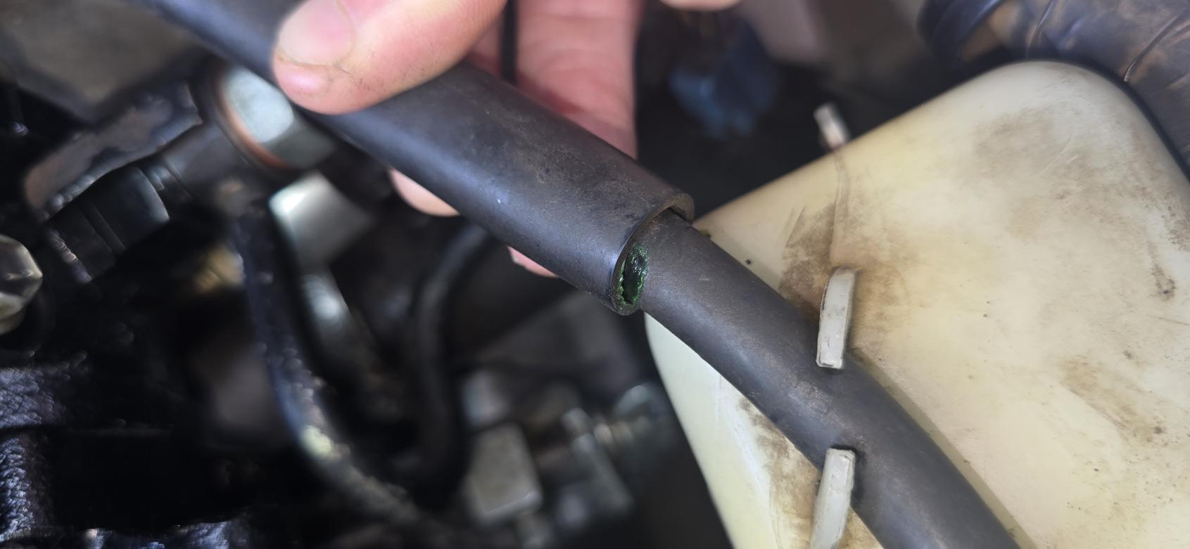

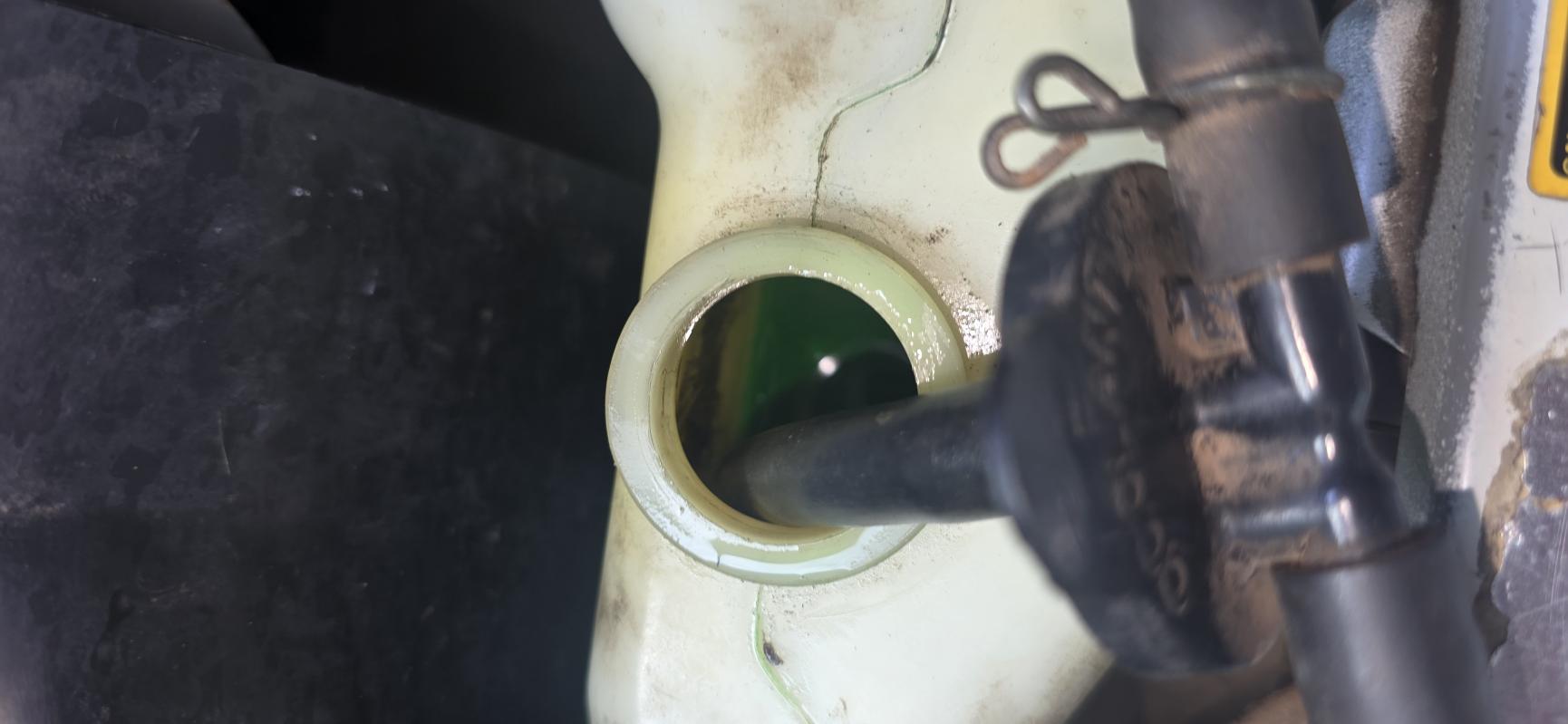

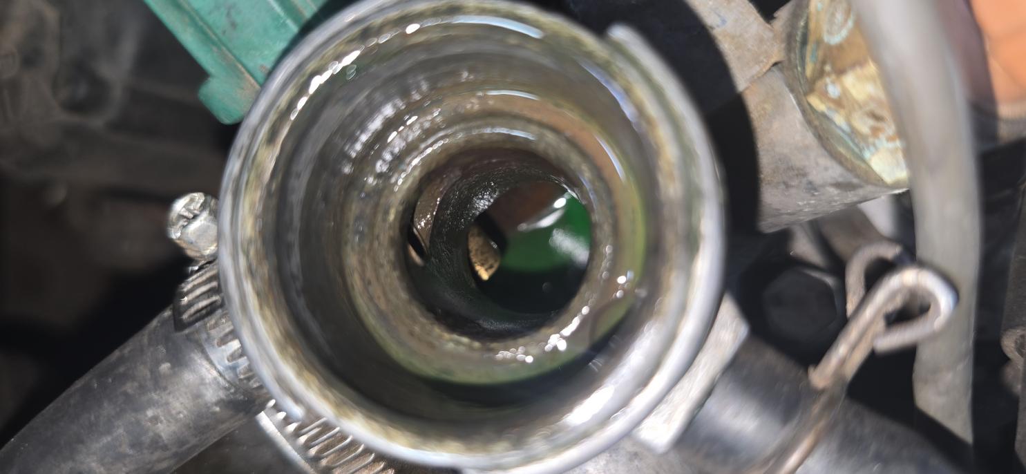

Llamavan's comments about the radiator overflow hose got me thinkin'. I cut/pulled it off. The little metal overflow tube coming out of the filler neck is totally corroded. I pushed a nail thru the metal tube to clear it and make sure that it's free to flow. I had the new rubber hose on hand so I cleaned up the tube as best I could, put some grease on it, put the new hose on and hose clamped it. This is temporary until I get a new filler neck. The old overflow hose had a bunch of rusty corroded gunk in it and no doubt it was restricting the flow of coolant. Hopefully the fillernecks are still available.

Update: I drove around yesterday for a couple hours running errands. Usually I leave the cabin heater on to help cool the engine. Yesterday I didn't do that to see what would happen. When I got home parked in my garage, I popped the engine lid and guess what? No coolant coming out of the overflow tube this time. I guess my temporary fix worked. I have the new radiator filler neck & gasket on order from 1st Toyota parts.
Thanks to llamavan for pointing out that little overflow hose as a likely culprit!:clap:
