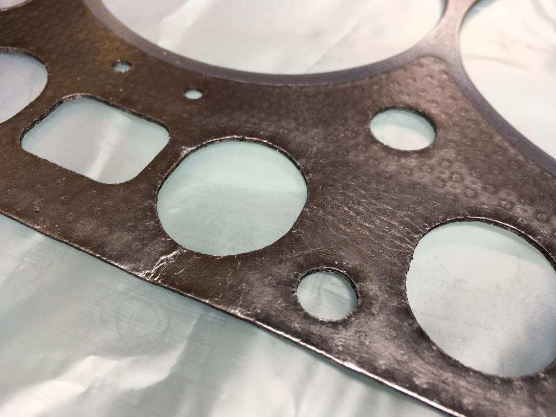

Head gasket damaged in shipping--OK to use or should I return it?
I finally got parts to complete my head gasket replacement and the gasket is damaged, despite the fact that I ordered the Valve Grind Kit which is purportedly better packaged. They (Village Toyota) packed it in the same box as the heavy exhaust manifold. It's got a definite crease on the edge, though at least the metal rings are all pretty flat. Consensus on the internet seems to be a bent gasket is OK but a crease is not. I don't really want to wait another two weeks for a new gasket... use it or return it? Grrrr...:pissed:Attachment 5501
Re: Head gasket damaged in shipping--OK to use or should I return it?
This is a labor intensive job and I would wait to get a replacement and know that I had good parts to start with.
If you install the questionable gasket and it fails right away your going to now have to do the job twice and to add insult to injury because you installed the faulty part you won't get a refund because now how can you prove to the satisfaction of village Toyota that the failure was not due to improper installation of the head gasket vs a damaged part out of the box. Certainly they would reason that if the part was damaged by poor packing it would be reasonable in their minds that you would return it rather than install it and besides it would always be in the back of your mind when is the other shoe going to drop
Thanks Jperl, that's pretty much how I felt but wasn't sure if I was overreacting. I went ahead and ordered the kit from my local dealer, they should have it in a few days vs. the two weeks it took to get this one. They said there were only six in the country so it's a shame mine was damaged! Hopefully I can return it.
