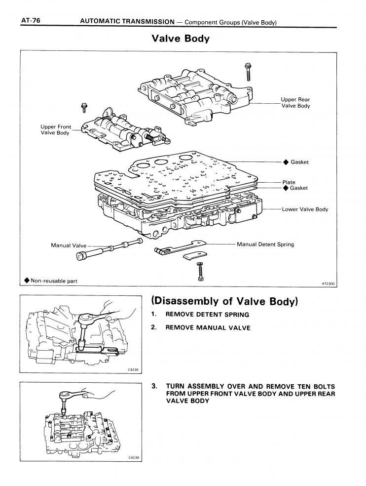

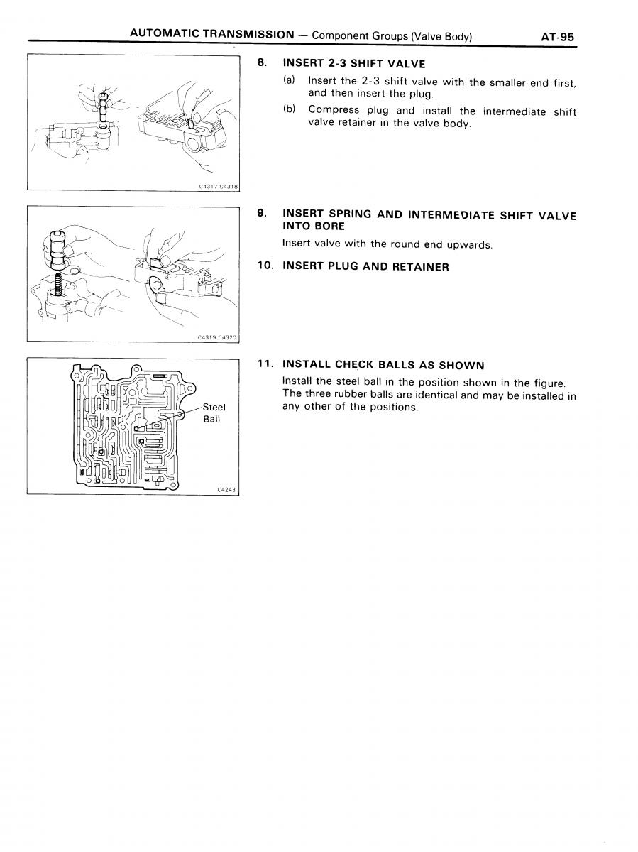

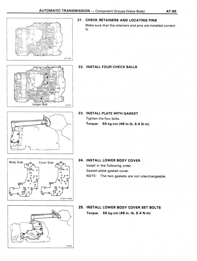

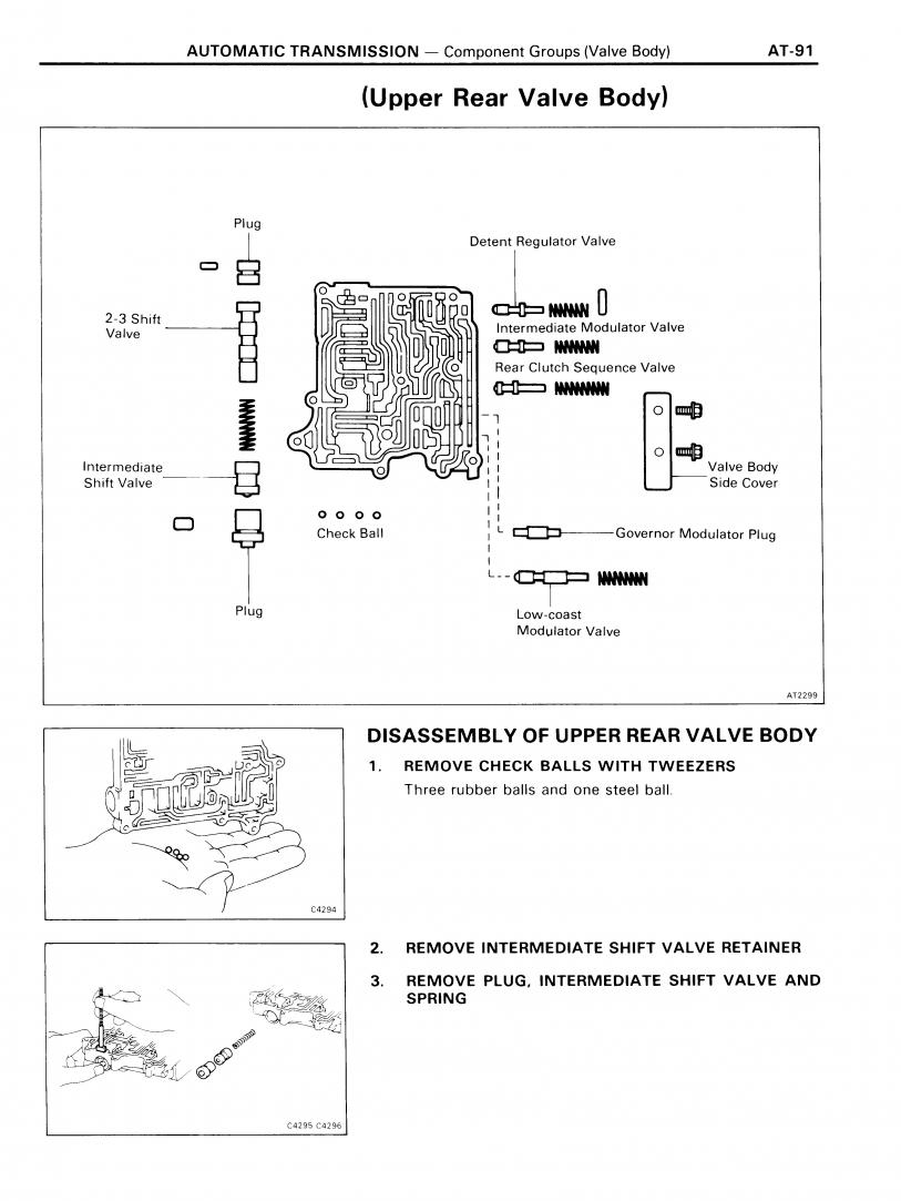

After reading the repair manual for quite some time I am a little confused. It seems like there are 4 check balls in the lower valve body and 4 check balls in the upper valve body.
Attachment 1510
In this picture there are two gaskets and a plate inbetween the lower and upper valve body. Are these the two gaskets that you said need to be replaced?

In this picture you can see 4 check balls and one of them out of the 4 is apparently a larger check ball. This is in the lower valve body. Are these the ones that need to be replaced?
Attachment 1512
Then here is the upper valve body which also has 4 check balls. 3 are rubber and 1 is steel apparently.
Attachment 1513
As you can see in the diagrams it looks like there are a total of 8 check balls. 4 in the lower valve body and 4 in the upper valve body.
Which ones need to be replaced? Upper or Lower?

The gaskets need to be replaced between the valve body and the rubber or Teflon check balls should be replaced. The steel one does not need replacing.
Any shop Quoting $1500 is quoting a complete soft part overhaul such as seals gaskets o rings clutch lining plates etc and usually a torque converter for that price.
Your repair does not require removing the transmission as it is an on vehicle repair so the labor is minimal. It should cost no more than $350
You could remove the valve body (just make note of which bolts were removed from where the manual explains how to make a template to do this) yourself and take it to a transmission shop with the parts from Toyota and ask them to repair the valve body. THat should not be more than 2 hours labor for a qualified shop
