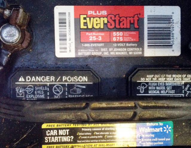

i gleaned some partial battery info for our vans from many searches on TVT but didn't see a specific thread. had a minor nonstart issue yesterday on a very cold morning. all battery and starter connections are good and clean and tight.
multimeter reads:
- 12.13V after sitting all night
- 9.3 cranking
- 12.85 charged
battery's 3 1/2 years old (6/2014)
i've read anything down to 9V cranking is ok but not great? a few specific questions:
- i've seen a few posts to buy the biggest battery to fit in our battery box
- but also read this might put more load on our alternators to charge a larger battery
- just wondering does anyone run a bigger battery and how big (brand / size) and does it seem ok?
- and any suggestions on decent good brands? looks like mines an EverStart from Walmart
(size 9" L x 7" W x 9" H)
i've seen Interstate at Fred Meyer - need to check Autozone
thank you!

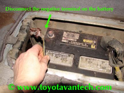

Question on your US vans: does the battery compartment share space with the radiator overflow bottle? On my KM30 Liteace van, it is supposed to. Mine bottle was missing, which I have finally located. Come to find out, it hogs some of the room currently occupied by my battery. Fitting both will require a rather short overall length battery, about 9.5" is all the room there is. Looks like the original spec for mine was a group 75/86, which should barely fit.
Re: Battery recommendation?
Papay
The battery compartment on mine s located behind the drivers seat in the passenger bay. It's an actual cage mounted through the floor and held in with 4 bolts that the battery drops into like this ...
