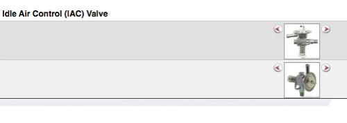

Issues has been resolved. I had overlooked one vacuum line (Doh!) the line that connects the IAC valve to one of those little ports on the side. It had popped off the plastic port where I couldn't see it.
plugged it back in and it fixed the code 25, high idle, and stalling after start up. Out of curiosity when would the IAC valve need to be replaced on these vans?
Re: 89 2wd van, codes 2 - 5 and 6
are you taking about the idle speed control(isc) vsv in between the manifold and airbox? or the big idle air.control valve in the clamshell?
