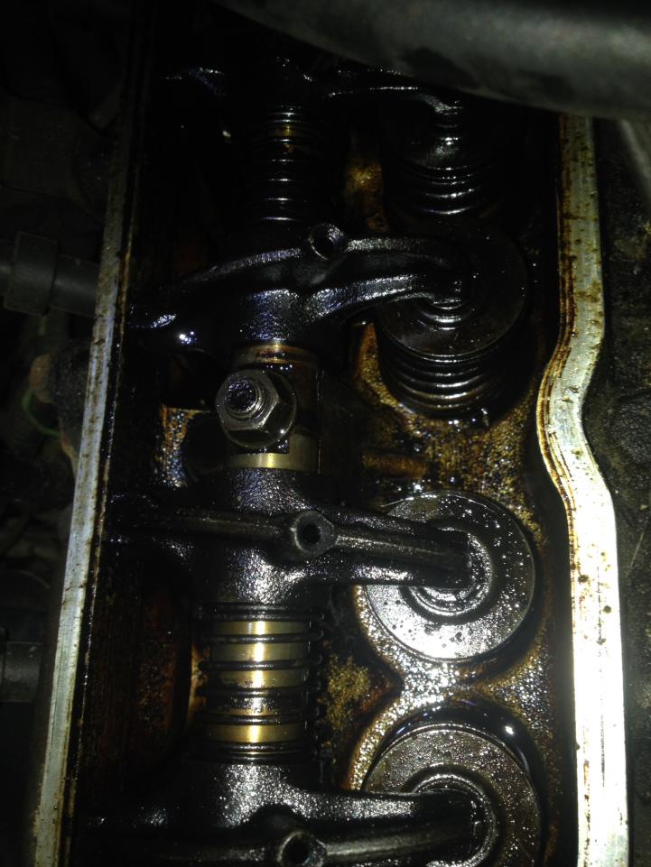

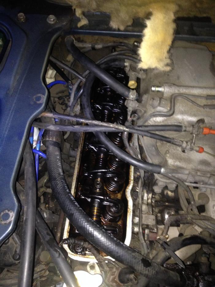

I decided to take the valve cover off and have a look at the valve train, though being a *very* novice mechanic, I'm not quite sure what exactly to be looking for :) I got the valve cover off last night, and it definitely still seems to be quite dirty in there. My next step is to take apart the rocker arm assembly and get the lifters out. Can anyone provide some advice on what I should be looking for to determine if I need to replace the lifters?

It sounds to me like you're losing oil pressure. One possible scenario is the oil pump pick-up screen geting clogged with chunks of sediment and/or clumps of sludge that have become dislodged. This would tend to happen when the engine is at high output (highway driving) until the screen cannot keep up with flow demand. When you stop & shut off engine, the suction from the pump goes away allowing the chunks to fall back into the bottom of the oil pan.
Typically engine sludge is not a problem as it deposits itself on surfaces that don't matter. I've seen the problem you describe before, but it's usually after somebody has put a product in the oil designed to "remove engine sludge" (basically dislodges it from surfaces that don't matter, allowing it to move into areas that do). I don't know if that's what's going on with yours, but I'd recommend another oil change and checking the drain pan for chunks. If you find chunks, then I'd pull the pan and give it a thorough cleaning.........perhaps replace the oil pump too. Tim
PS: I would think the lifter noise and rough running are a symptom, not the actual problem.

I'd go the route suggested by Timsrv before I'd do anything else okalex. I replaced all the lifters in mine awhile back and while it is doable, even for a novice, try the oil pump first. If your lifters were collapsed they would be loud from start up. Also, from my experience, under your valve cover looks pretty clean to me.
