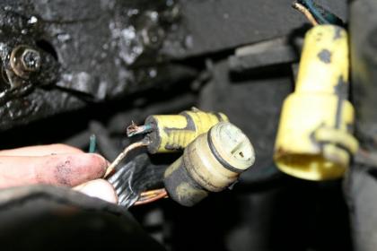

Does anyone know if you're supposed to have 12v to fuel pump even if you're NOT jumping the fuel pump test connector? I have 12V to the connector shown below with the FPCC jumped && without it jumped. Fuel pump doesn't whir up and trying to diagnose. I'm thinking the pump is toast but wanted to double check to see if i'm missing something else. Thanks!

With the key set to "run" and engine not running, when you install the jumper in the FPCC you should hear the Circuit Opening Relay click behind your glove box and the light blue wire going to the pump should start getting +12VDC. When you remove the jumper you should hear the COR click again and 12VDC should not be present in the light blue wire. If power is present all the time (jumper or no jumper) and you're not hearing the click, then you likely have a stuck (closed) switch inside the AFM. It's also possible somebody cross-wired the system as to defeat the COR, or perhaps to make it run with a bad flow switch inside the AFM. Having 12VDC in that light blue wire all the time is a safety hazard. If by chance you had a serious accident and the fuel system was breached, the fuel pump would continue pumping fuel....possibly all over the place (not good if there's an ignition source present and/or you're injured/trapped inside) :pissed:. Tim
