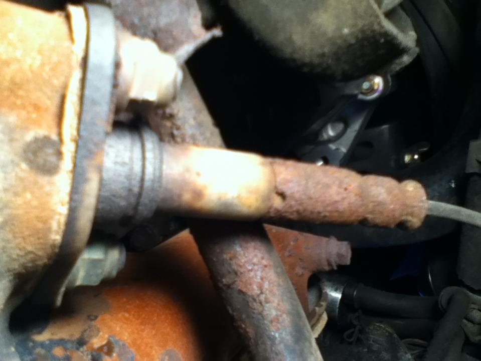

yesterday i was doing driving around town and the can stalled which it had been doing intermittently. usually it would restart immediately but yesterday it took a minute or 2 for it to get going. it would turn over but not start. last night i replaced the oxygen sensor and the FL 1.25B. today it still has problem starting. it always starts but i may have to turn the key a few or quite a few times to get it going. heres a pic of the old oxygen sensor.

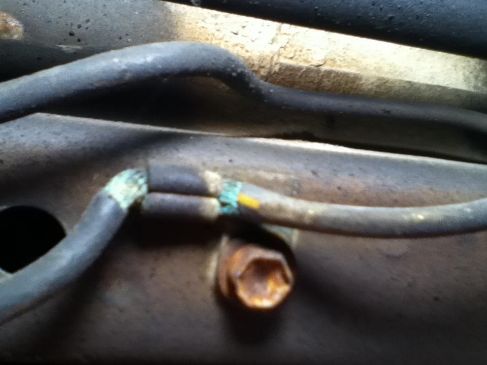

today i picked up a new beck-arnley TPS (it was $97) which i imagine will fix the roaming idle/rpms (it only does it sometimes!) and some new battery cables. when i was underneath the van last night i saw that the negative battery cable was totally exposed in one part and the wire was corroded.
Attachment 1770

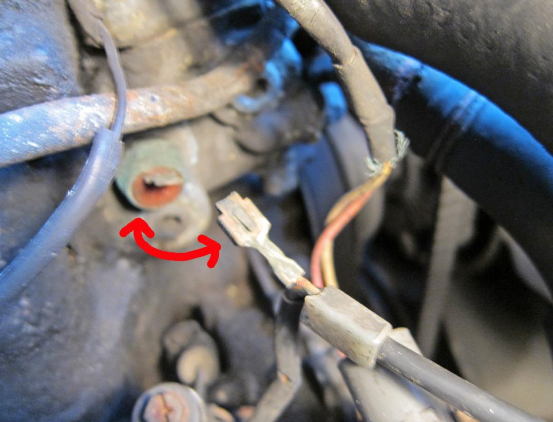

i was looking around for corroded wires or other things that may be causing trouble and i found this connector but i have no idea what it it. it on the front right corner of the engine block. it was very rusty and loose. i sanded it and it seems to stay on better. the pic is blurry... you can see the belts in the background (also blurry). the orange circle that the paddle connetor comes out of (on the engine) is rusty!
Attachment 1778
i was trying to put a new positive battery cable on but i couldnt get at it. it was one wrench size i couldnt find and theres no way a socket would reach in there. i was going to put on a new rotor and cap but wanted to check if this little connection was what was giving me trouble. the van seems to be starting better but it still needs the TPS which havent put in yet... i forgot to get a gasket for the throttle body. hopefully i can find one today.

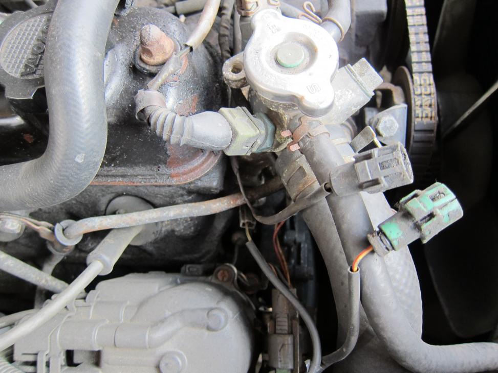

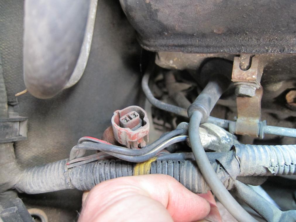

i also came across some connectors that were not connected to anything. they did have caps on them like some of the testing ones do but some or all may be for testing. all 4 were on the right (passenger) side of the engine. anyone know what they are?
Attachment 1779Attachment 1780Attachment 1781
in the pic with the 2 connectors...... i pulled them out to take the photo but they were hanging way down and were not visibly obvious at first.
thanks
