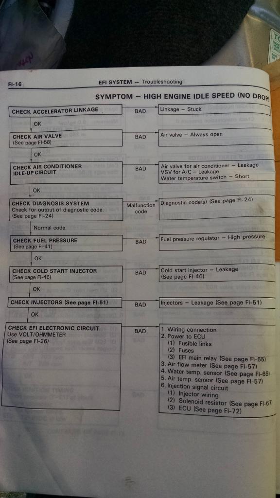

I also found this page in the manual for the '87. I also have an '89 manual which doesn't have this page, oddly.
Attachment 1948
The AC idle up vsv doesn't seem to be leaking, and the resistance checks out. I'm not sure what the air valve for AC is, or if I actually have it after removing all the AC components. Water temp switch I'm assuming is the Coolant temp switch? This also seems to be ok, no braking/chaffing of wires.
