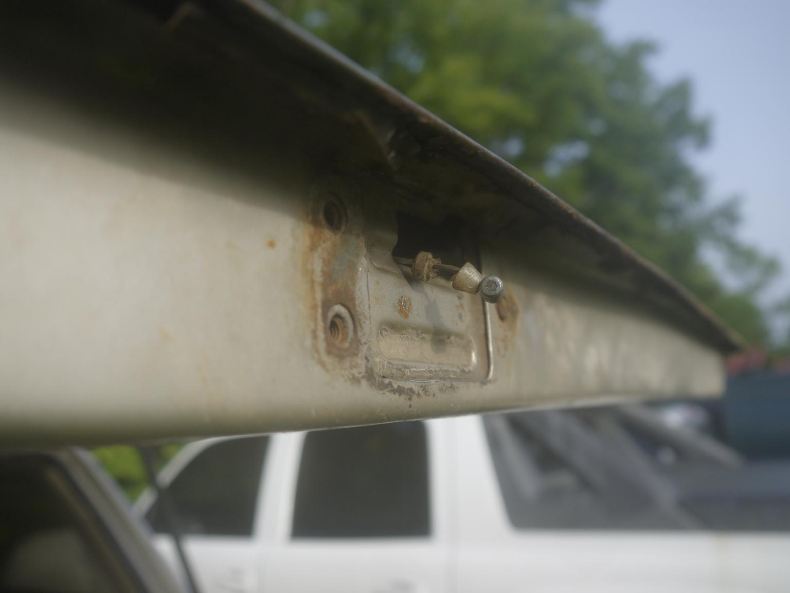

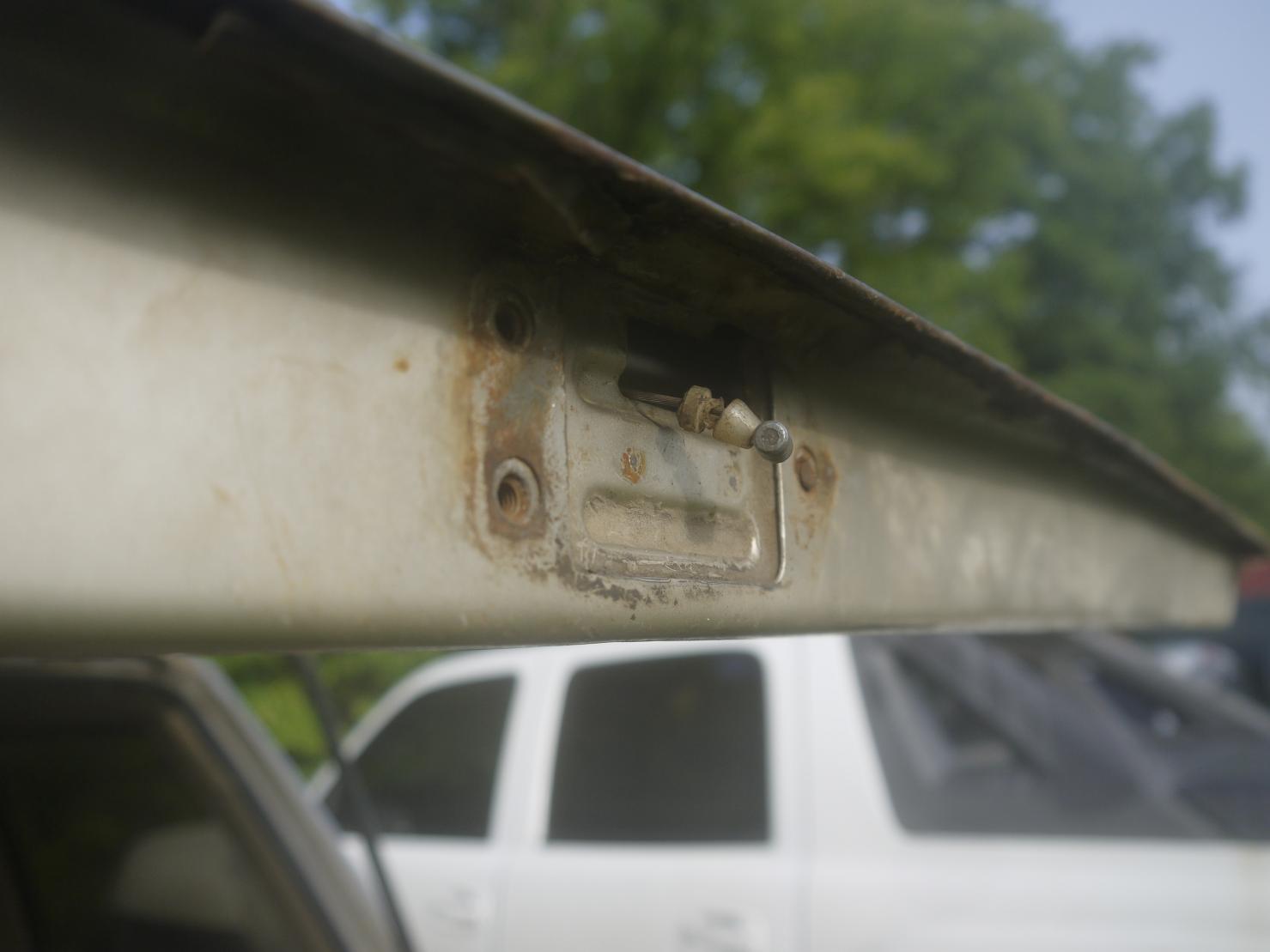

Currently my tailgate is held closed by removing the trim and ratchet strapping the gate to a fixed point inside the van.
Obviously I'd like a somewhat more functional tailgate, but the cable surround which anchors it to the fixed part of the latch is broken.
Any ideas on how this can be replaced or fixed?
Attachment 1882
Attachment 1883
I'm also down to 1 of the 3 original bolts holding the lock onto the gate body, but I'm struggling to find similar bolts anywhere.

Have you tried pulling it out ( take a lot of pictures) and looking at exactly how it works? Then you can figure out exactly what parts you would need from a donor van. Seems like you can't make it any worse if it is already broken.
Re: Tailgate latch cable & Bolts
The 2 broken white plastic pieces are supposed to be part of the cable sleeve and they clip into a fixed point so the cable has something to pull against.

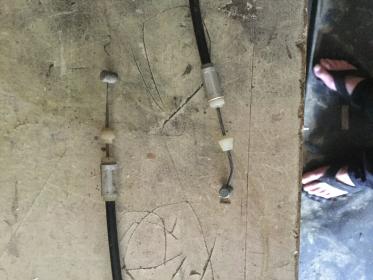

Didn’t see a solution to this broken part in the thread. It’s the cable that connects the handle mechanism to the latch. Think a bike shop could fabricate one of these?
