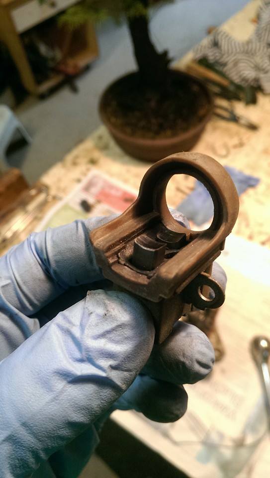

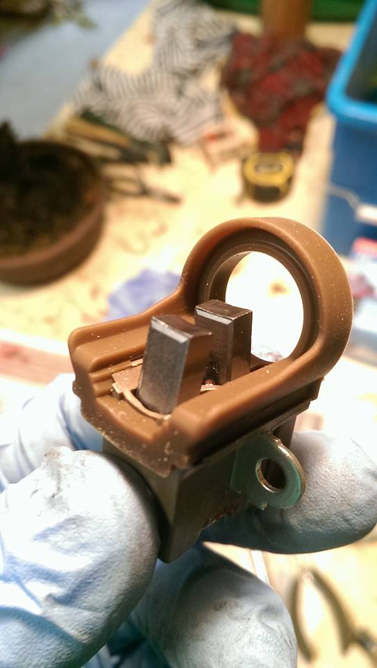

Attachment 1979Attachment 1980 An old and new shot. You can see from the photo of the old brushes that there is some uneven wear going on. HMMM
