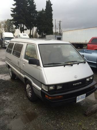

hmmmm. Below is a picture of the beaut'
156,000kms, little to no rust.. engine compartment is immaculate, and a nicely built bed in the back w/ subfloor underneath.
