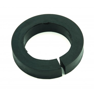

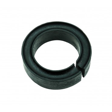

So it looks like the difference is that the Mr. Gasket #1287 has grooves on BOTH sides which would permit it to be installed in between the coils. The Mr. Gasket #1285 has grooves on only ONE side which requires that it be installed on either the top or the bottom of the spring.
Mr. Gasket #1285
http://shop.mr-gasket.com/rubber-fro...g-booster.html
Attachment 2043
Mr. Gasket #1287
http://shop.mr-gasket.com/suspension...ng-spacer.html
JohnAttachment 2044
