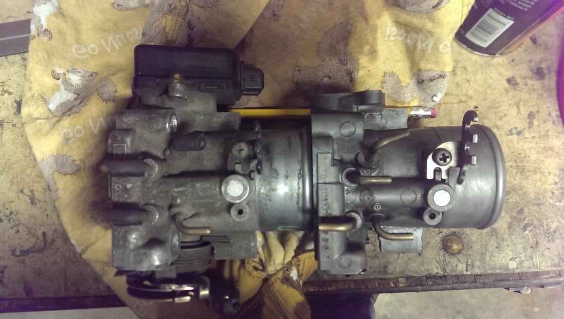

http://i65.tinypic.com/2nrengh.jpg
this picture shows the broken tube that came off of the throttle body (where the bolt is plugging off currently)
is there anyway to fix this succesfully or am i better off finding a new one?

The TB is discontinued from Toyota and has been for about 10 years now.
What I did because I am not in a cold climate, I just bypassed the TB bridging the coolant hose between the two feeds to the TB. The coolant I believe prevents the throttle body plate from freezing closed. There is no temp sensor in the TB I recall. Your temp sensor for coolant is at the neck of the radiator cap So if you do not live in a place that gets below freezing I would not worry about implementing this workaround
