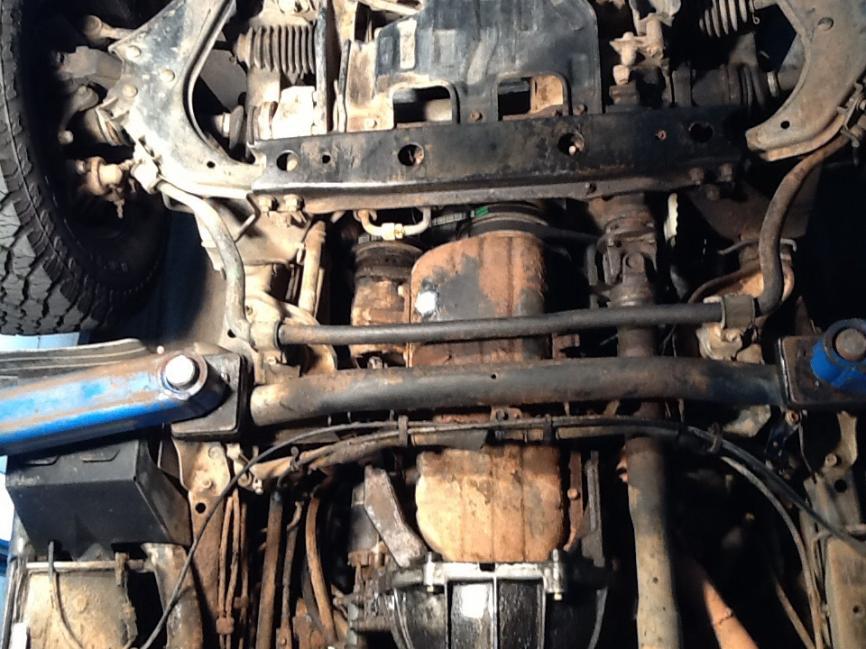

Finally getting around to taking pan off..up on the lift at the moment and want to get some wisdom before moving forward. I'm assuming that I'll need to remove sway bar. Will the pan rotate and shimmy out with only sway removed? Thank you.

Re: Stripped oil pan.
I happened to have the sway bar off when I did mine, probably a good plan to have it out of the way as it was a tight fit.
Make sure you pull the oil level sensor before pulling the pan and you should be good to go.
Can't remember if anything else being in the way, but I don't think so.

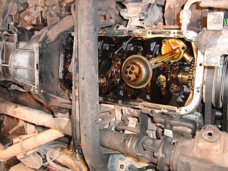

Anything I can maintenance or check from the bottom end of engine with just oil pan off?

I had a heck of a time getting my pan(4x4 also) back on without it leaking-it may have been bent in the removal process but I didn't know what I was doing and didn't check for straightness. One of those cross bars should be moved, maybe both, I can't remember. And I think the two mounts that attach to the transmission(from the engine) can be removed or at least loosened so you can get to one of the pan corners that was impossible to thread on by hand. I didn't have a lift so that will definitely be a huge benefit for you.

DJ - now that you mention it, I did remove the crossmember between the lower control arms.
(I also pulled the dipstick out, the fewer things to get around the better)
I also did mine in the driveway and being on a lift would have been a lot easier.

About the only thing to action while you're in there would be to check (and clean) the pick-up screen for the oil pump .

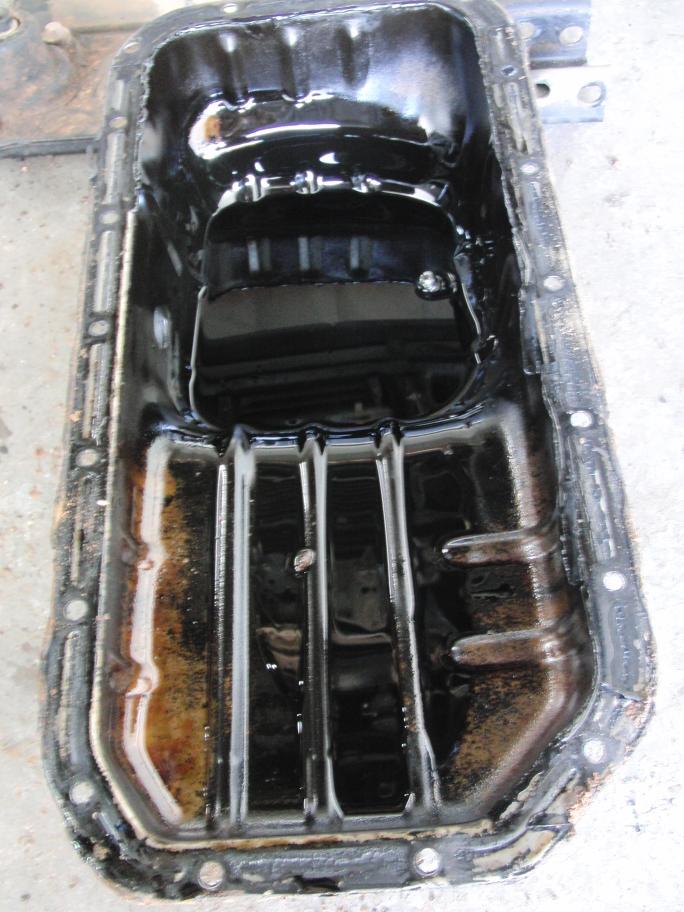

Old out and new one in. It was a careful squeeze in there to not drag the new oil pan FIPG seal as I was sliding it in but it worked out. Getting the bolts back in was easy except the one corner I mentioned before. Took me FOREVER to finger it in enough to get a the socket I made in to tighten.
here's a pick after pan came off. I was expecting to see more sludge or at least metal shavings after my close call loosing all my oil while driving...
