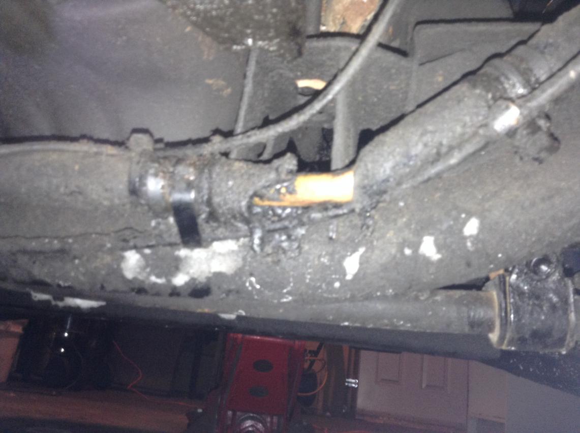

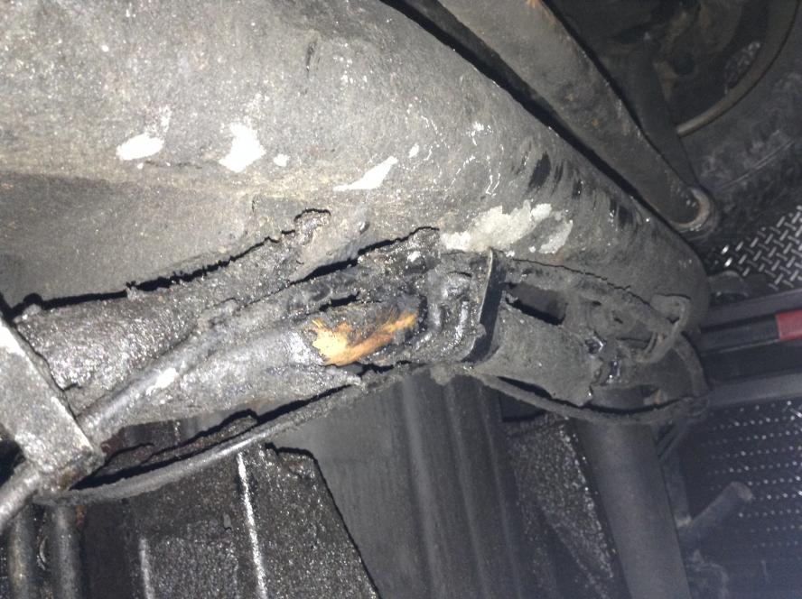

i think i hit something underneath when i tried to pass over a frozen snowbank to park in Montreal. There is a prestone line and 2 wires. the symptoms appeared after i tried to park.
You can see where the snowbank hit the coolant pipe (copper) but there is no leak. I don't know what to de next....

That's the coolant pipe from the rear heater back to the block; fortunate that it's not leaking because those are long ago NLA. For future reference (if it does leak), that pipe can be replaced with bulk hose.
The "wires" are rear HVAC control cables; nothing to do with your fuel issues.

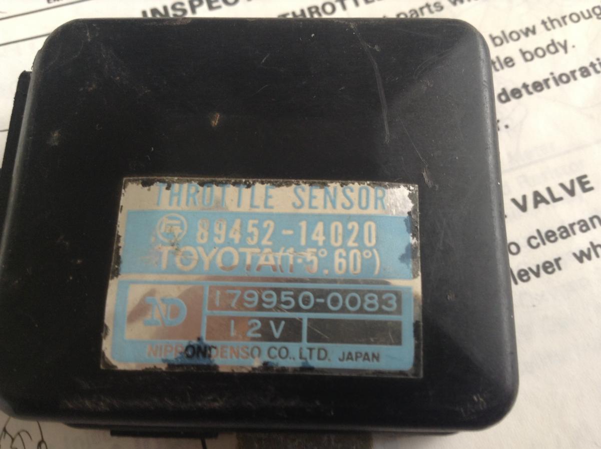

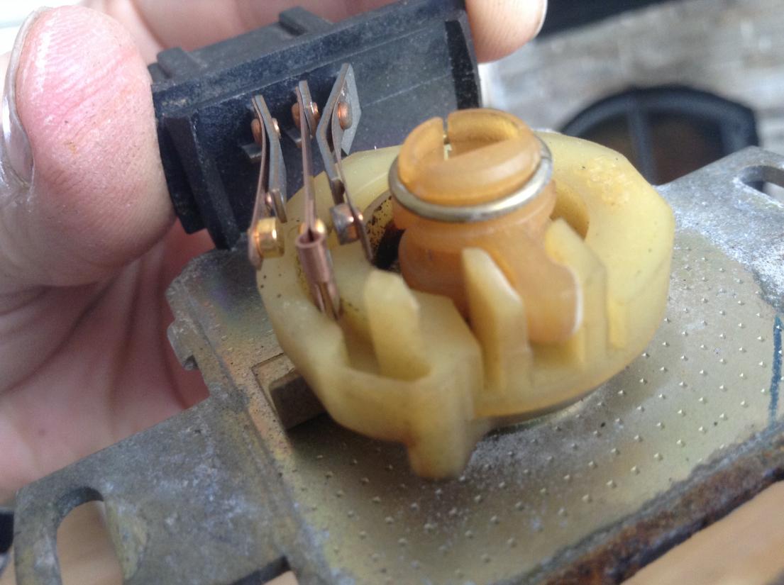

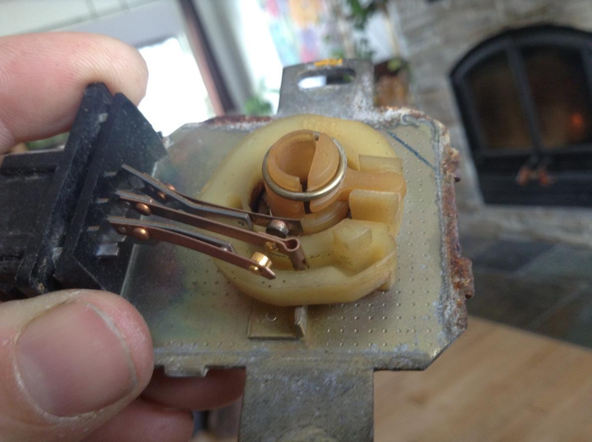

Here is some pictures of the spare TPS i found in my parts box. I can't compare it with the one still on the throttle body but it look not so bad. Maybe the right blade seems to be dark.
I tested continuity and it's good.
For those who already seen Bad TPS, how look this one compare to a faulty TPS?

I'd have to say the inboard contact is burnt, but I am no expert.
Given what a PITA they are to replace, do you really want to spend a couple of hours messing about only to find you're still having problems?
You won't know if that TPS is bad or if the problem lies elsewhere?
Even if the used one you have functions, how long do you think it will last? Days, weeks, months???
Stuff a new one in there and be done with it for another 20 yrs.
For what it's worth, I had 2 spares of unknown origin, would have been a lot cheaper than what Toyota Cda wanted for a new one.
Hindsight being 20/20, it was still a good call, simply because it eliminated all the guess work and all of the problems.
Just my 5 cents. (we don't have pennies up here anymore)
