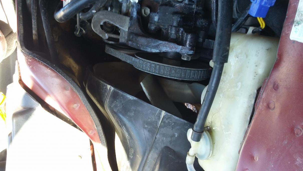

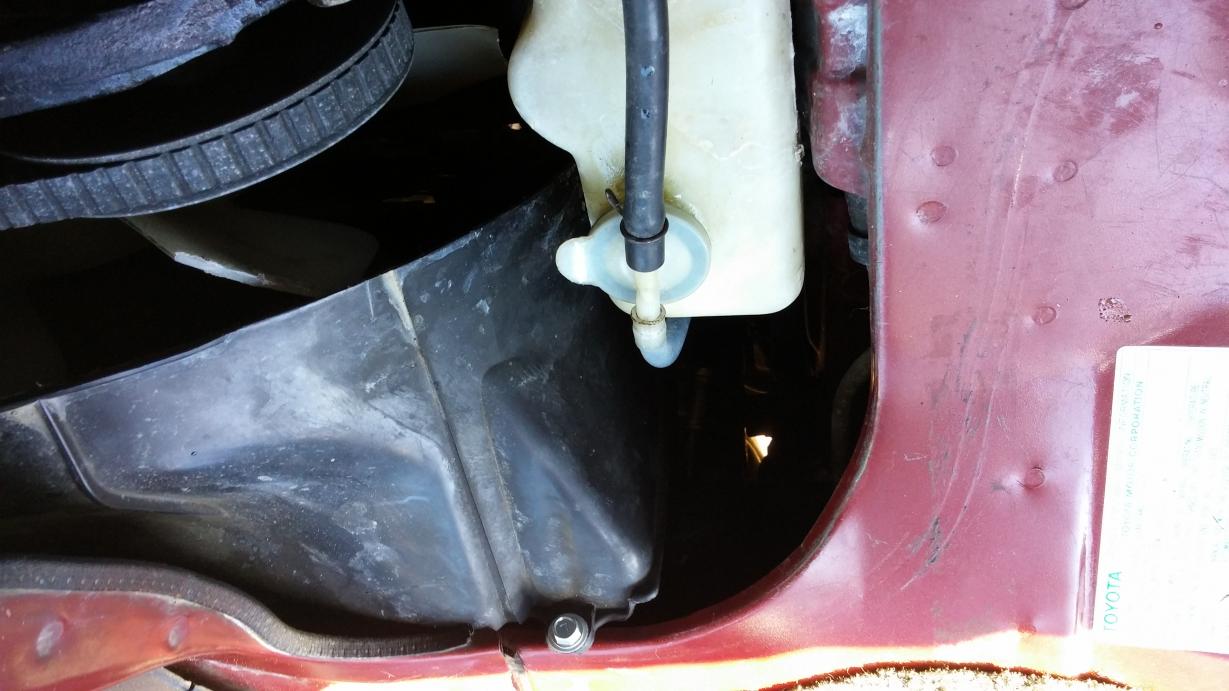

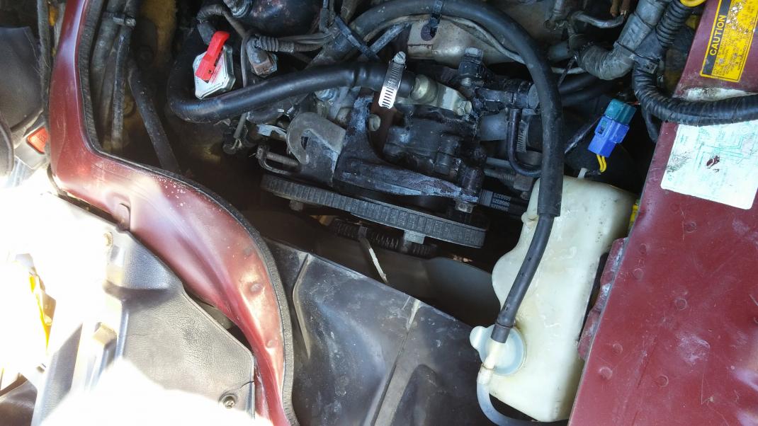

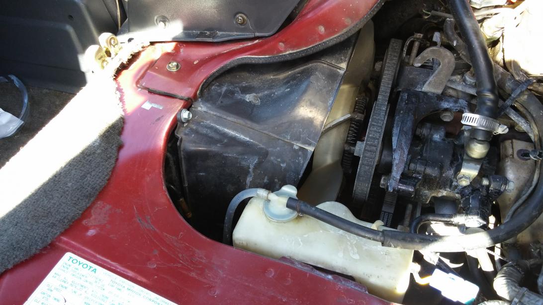

Attachment 2240Hi all, I just purchased a 1988 4x4. It had a new water pump and radiator installed but the po left the fan shroud off. I drove it home and had to go over a few passes. On the last and worst pass I had to pull over and let it cool down. I figured the shroud was the problem so I installed it when I got home. Funny thing is the shroud was hitting the fan and the bottom of the shroud is in interference with the front axle. I made it work, but it seemed to have a lot of gaps around but I figured it should be fine. We went on a short trip and had to climb some long but semi gradual hills. Had to pull over a lot even with the shroud on. Van was running slightly over half going 65 on flat ground,rose slightly on most uphills.
I've done my research and the thermostat isn't oem but is new, so replacing that with new oem. Also I'm not getting the roar from the fa like everyone talks about, so replacing that as well.

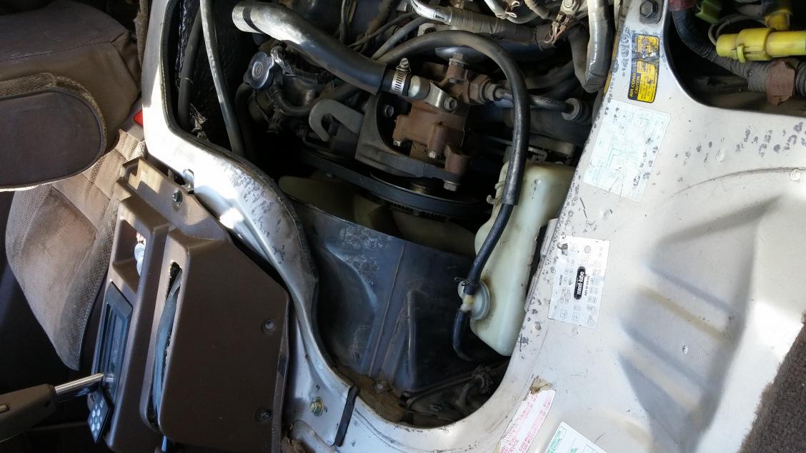

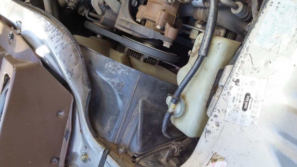

My real quandary is this however, I only have my 2wd to compare it to, the 2 seems to roar when cold if I rev it up to about 1500 to 2000 rpm, don't really wanna go anymore than that. I drove the 2 the same trip and was not trying to be easy over the passes so that I could assess the condition of the cooling system and it didn't flinch, so I think its all good there and something I can compare to. But upon inspection of the shroud and radiator placement on both vehicles I realized they are sitting in very different spots. In the 2 the radiator is situated closer to the engine and the shroud is up against it and also enclosing the fan much more. There seems to also be something in front of the radiator, like an ac condenser or something but I don't know for sure, this does not exist on my 4wd, the radiator seems to sit more forward where that condenser thing is. This also causes the shroud to not be able to fit over the radiator correctly and in turn not surround the fan as well. I just don't get it as The radiator seems solidly supported which makes me think it's in the right place, but all I have to compare the 4x4 5 speed to is the 2wd automatic. The 4x4 does have a radiator from an automatic though. I've included some pictures to help illustrate but any help is appreciated! I just don't know if it's supposed to be different or not with the different models or how I can move it as I don't see any other supports.
Again, thanks for any help, I'm stumped. Usually you can tell where a part should go, especially a radiator!

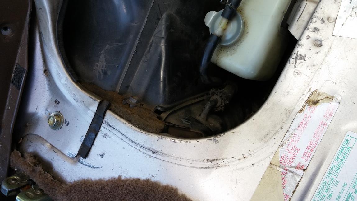

Sorry don't know why the photos are upside down! Also, to comment on the photos, the red one (4x4) you can't even see the radiator in the picture and hardly in real life because it is so far back, not the case in my 2wd
Re: Another overheating issue, searched but need insight
You have a 2WD shroud installed in a 4WD van. They are not interchangeable and finding one for 4WD is like finding a leprechaun:)
Haha thank you! So the radiator is in the right place? I confirmed there is some sort of condenser in front of the 2wd radiator and nothing in front of the 4wd radiator. The blower at the front is also much larger in my 4wd than the 2. What's the reason for this?
Which blower are you referring too? If your 4WD has A/C, the condensor is mounted horizontally between the front axle and front bumper. It has a louvered cover on the underside and two fans on the top. The 4WD radiator is smaller in height due to the space needed for the front differential. Presumably the condensor was relocated to allow the smaller radiator to cool more efficiently. The shroud on a 4WD has tabs on the bottom that locate into clips the same as the 2WD but the bolts on the top of the 4WD thread in vertically as opposed to horizontally for the 2WD. This is why the shroud on your 4wd appears to be attached to the engine cover with sheet metal screws.
