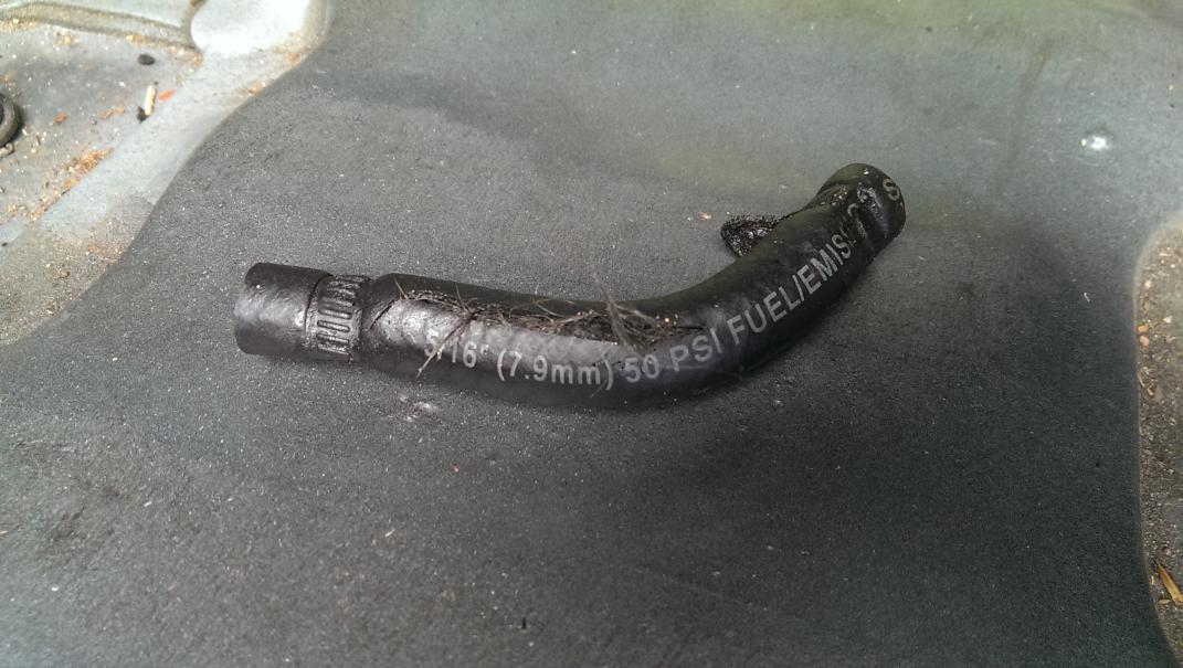

This happened to me too back in January. I was driving back from Phoenix on I-10 when the temperature gauge started creeping up and wasn't stopping. I turned on the heater, which at first blew hot, but towards the end was just blowing room-temperature air at me. I pulled it over right before it got up into the red, shut her off and opened the lid. After a mondo expensive tow back to Tucson, I was able to find the culprit.
Attachment 2277
I remember the previous owner stating that he had replaced the hose of death, so an access hole was already cut (and the cut out panel was held together with duct tape somehow :dizzy:). If you look at the hose, it was fuel line hose, which almost surely was the reason behind the failure. Patched her up properly and no more leaks!
These hoses have been the end of many of our vans, so I'm glad to hear that you caught it in time and it sounds like no real damage to the motor was sustained.
