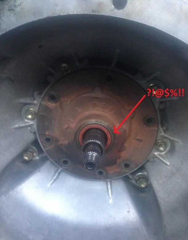

Torque Converter x Transmission seal
How in the dickens do you remove this thing? I cant tell where it ends and the steel oil pump body begins. Anyone have experience doing this on autos?
Does it just pop out? I'm just worried about mangling it and making it even harder to remove.
Attachment 6430
I damaged the old one poking at it, so there's no going back. :bdmd:
Re: Torque Converter x Transmission seal
looks like a common oil seal, should just pry out, one of these makes it easy...
Attachment 6431
Got it out. It had a steel outside ring that made it really hard to extract, esp with the shaft still in the middle of it.
