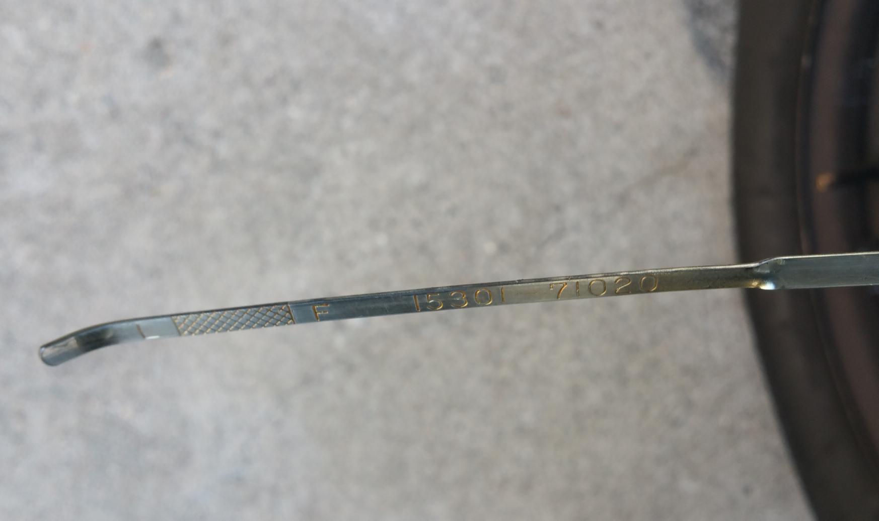

My dipstick does have a rather sharp bend at the very bottom. Is that normal?

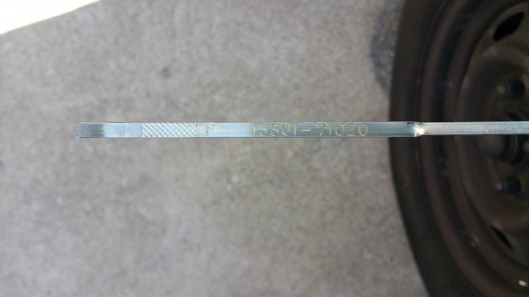

Here are photos of the bend at the base of the dipstick. Normal?
Attachment 2441Attachment 2442

Re: New Owner - a thank you, and a question on fluid oil capacity.
NewVanOwner
Normal.

If you run with the bigger oil filter the van will hold approx 4 quarts, but what you're seeing is close enough. Your dipstick looks normal to me. Tim
