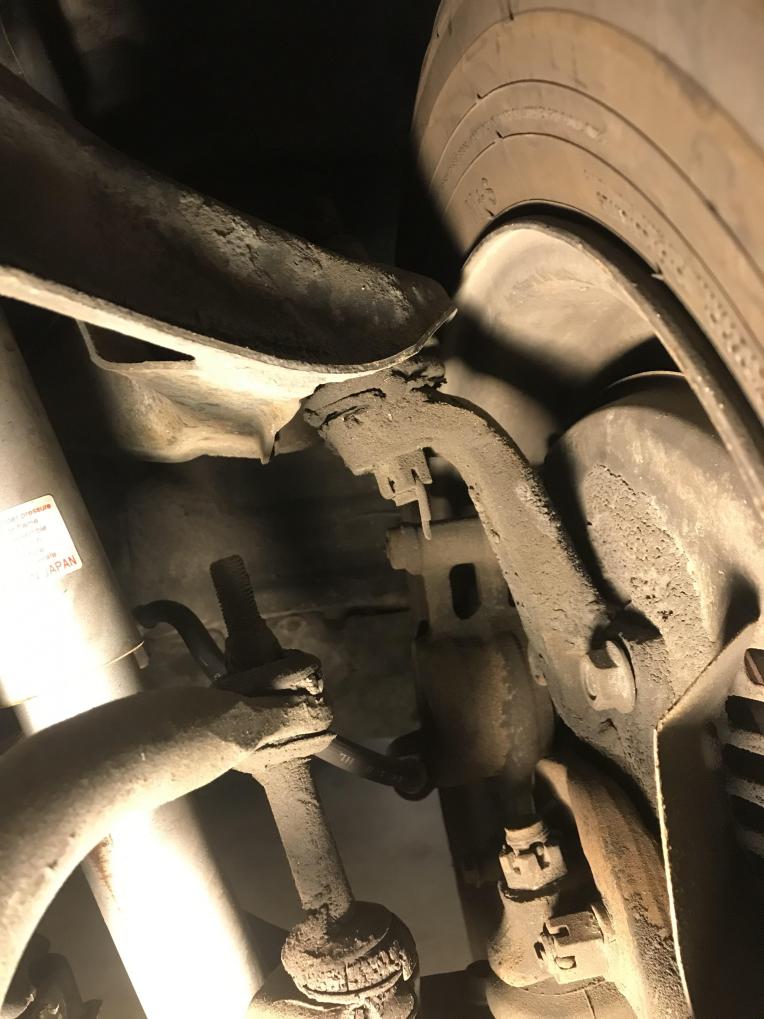

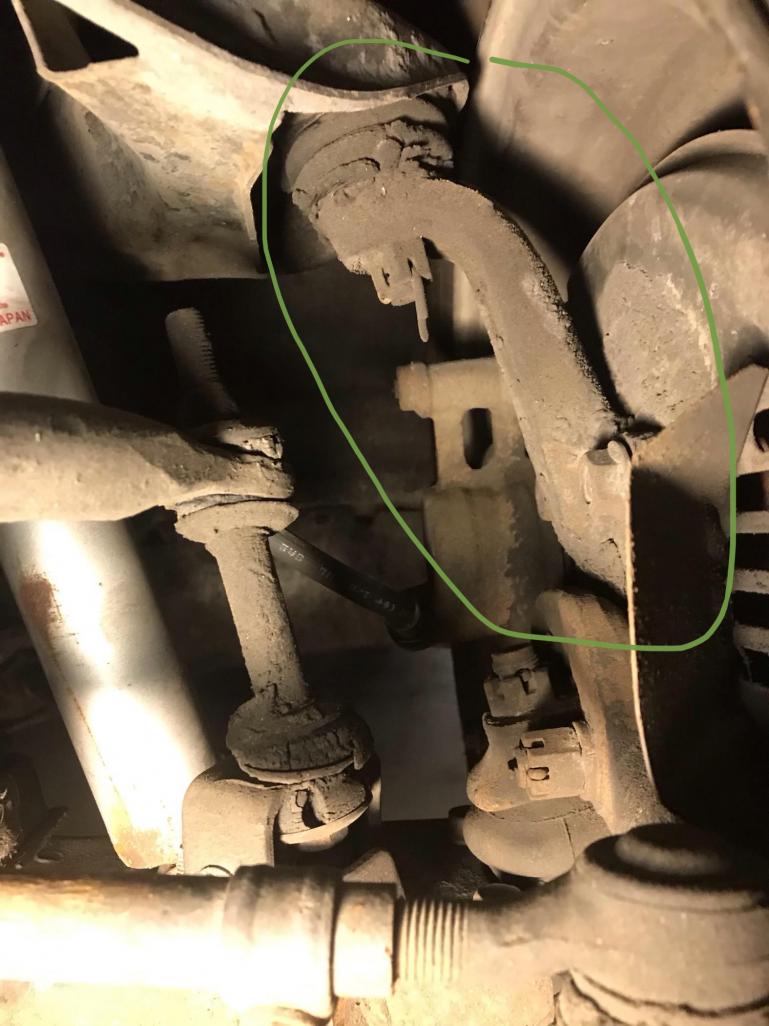

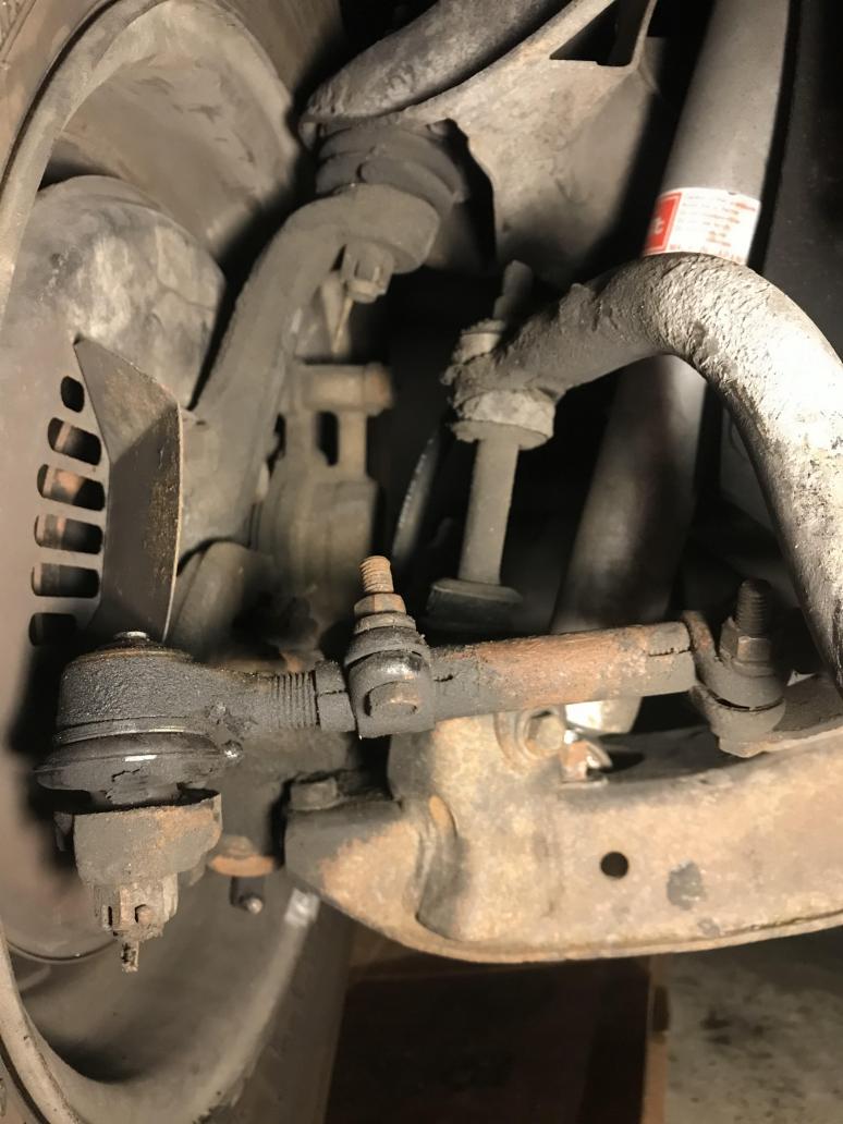

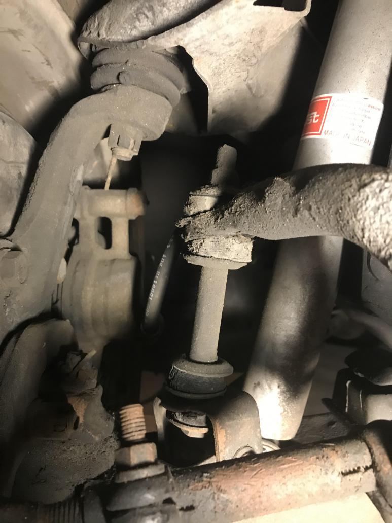

I'm changing my rotors and pads... And I thought it will be a good idea to change more parts while I will have the space.. So I just ordered from AutoRock 2 Stabilizer Bar Link for both sides (MOOG K700528).
I have added some pics below, can you please tell me which part is the one in the cycle? Is it my upper ball joint? Bc in Rock Auto the part looks different, I'm confused? Also if I want to replace only the bushings can you please help me find the parts? Or I may have to replace more parts if there are really bad, please let me known I'm happy to hear your recommendation.
Thank you very much!!

With some research, I think the name of the part I asked above, called Steering Knuckle and on top of it is the upper ball joint.. please let me know if Iツ知 wrong..
So by changing the rest of the parts, I will go and order the upper and lower ball joints as well.. so I can be more safe.
Re: Control Arm Bushing Noise
IQ - you are correct

You are totally right!! I知 not sure if they are the original ball joints but from the pics are not looking that bad, I will check them out while I知 working on the van changing the other parts.. I believe my Stabilizer Bar Links are in a really bad condition I知 feeling it every time I drive the van, also sometimes I知 getting a quick sharp noise from the passenger痴 side when I知 turning my steering wheel.. what should I check for that?
Those link ends do look old and cracked and definitely the first place to start.
The Van is the same as any vehicle, really.
Check anything made of rubber, both visually and with a bar.
If you see rubber with cracking, then its due for replacement.
The rest is just checking for play.
Easiest way is a long screwdriver or prybar, (1-2ft) and GENTLY apply pressure, then watch the how the bushing behaves.
Generally speaking mounts and bushings should give a bit, but resist movement and return to normal position once released.
Anything that jumps &/or doesn't return to position warrants further inspection and likely replacement.
Sometimes you wont even see the movement, but will feel it thru the bar
And please, be careful what you pry on and against, last thing you want to do is damage something else.

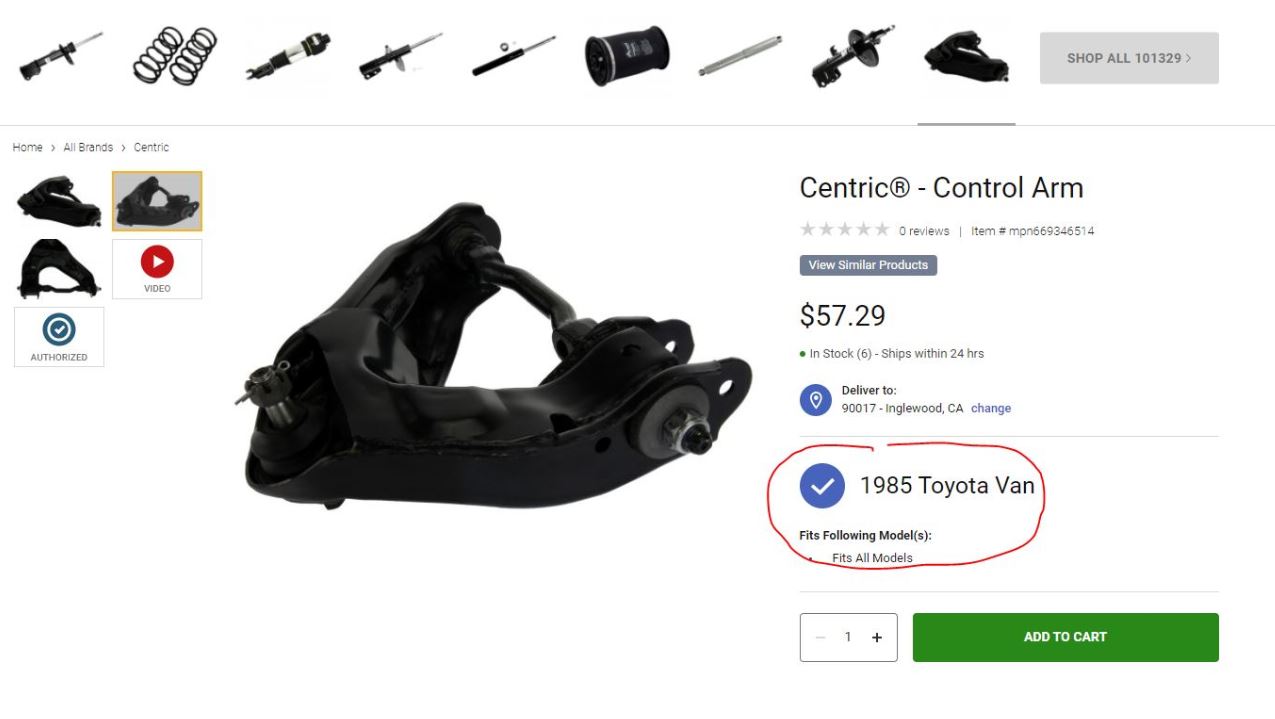

So I found this site selling these whole upper arms for '84
https://www.partsgeek.com/catalog/19...joint_assembly
But then the same part in other website I found it's only for 1985.. hmmm?

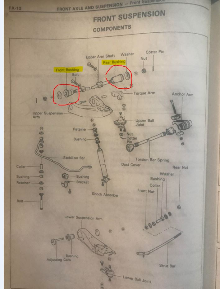

So I'm thinking to get only the bushings and replace them. Do I need 4 front Upper bushings #88912549 2 for each side? I'm looking the manual's pic below, are the Front and the Rear Bushing the same part?
Attachment 10158
