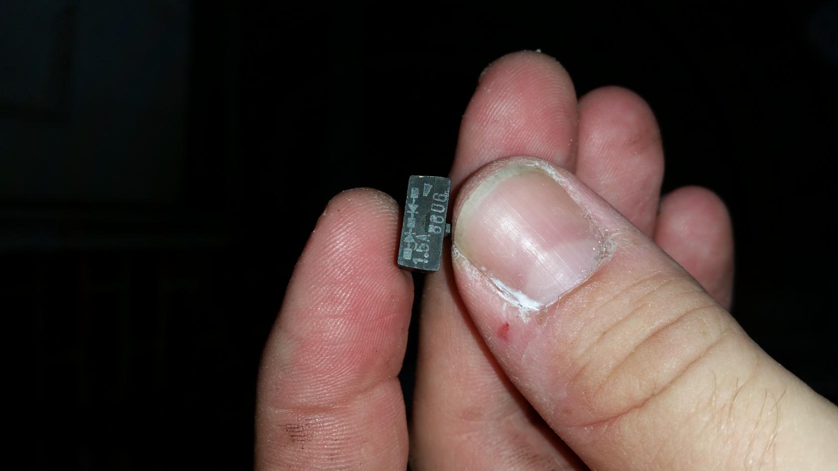

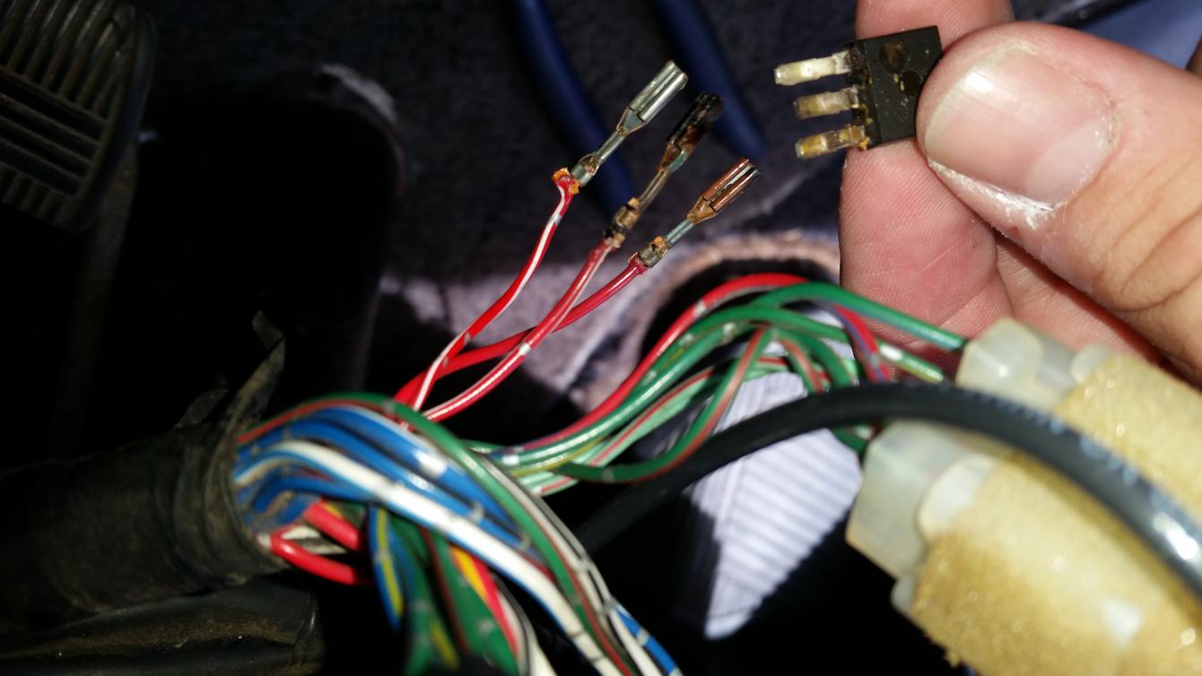

Looking for some info on what I think is a diode. Its in the wire bundle at steering column. Orange plastic is melted. Has 3 wires red red white.
on tvp there's a partial thread where wonder wagon references kcg795 and says that this is a diode.
My girlfriend just bought an 89 van 2wd. Headlights don't work. P.o. bypassed with wires to lights into cab and a hot wire to make them operate at night, and unhook when done driving.
starting my trouble shoot, and found this melted orange diode. Three wires.
I did a search for orange, headlight, diode and got no matches. Has this been discussed before? Anyone have info on the wires to this diode? Maybe I can bypass if nla from toyota

I know that if i hookup two of the wires from the diode, the high beams come on.

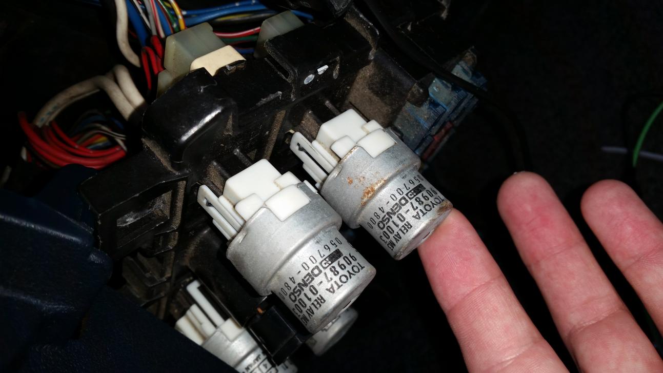

The diode has 3 wires, two red with white stripe, one just red. When the two with white stripes are touched together, a relay clicks. It is the bottom right relay in the fuse block. I dont have an 89 manual, i do have 87, and 84. I cannot find this diode in the wiring diagram... maybe im looking in the wrong spot?
Seems like fuseable links are all good, this vanbhas codes for tps, ign, and o2 sensor, and the headlight wiring was vypassed by previous owner. Attachment 2934
