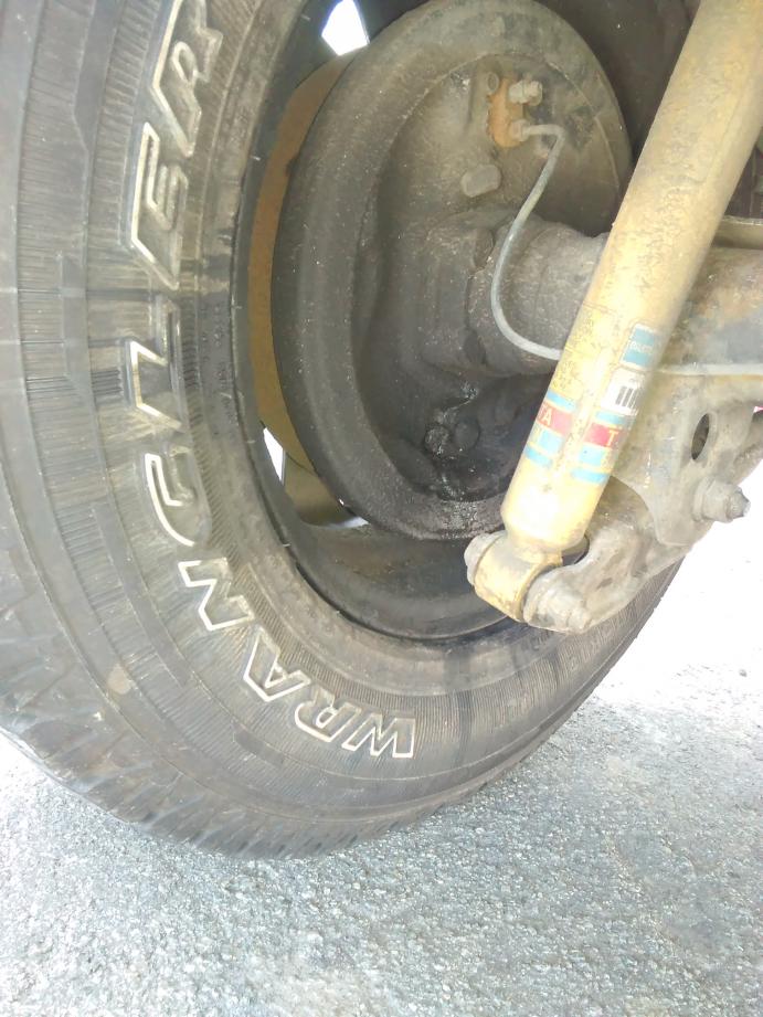

Yesterday I added some gear oil to my differential (2wd 1984) which has been leaking from the pinion oil seal. I'll be replacing that seal as soon as it comes in.
In the mean time, I needed to drive the van probably 20 miles or so, and I noticed this morning that my left rear wheel is leaking a lot of oil at the axle. Probably more noticeable because of the oil top-off.
Do I need to replace both my axle oil seal and the retaining gasket? Anyone have experience with this job?
Should I go ahead and buy/install new wheel bearings?
Thanks for the insights

I'd want to put it up on stands (well secured) and run it in gear, using a stethoscope (or long screwdriver against your ear bone), listen to the pinion and wheel bearings.
Then I would pull the rear drums and see how bad things are inside but its entirely possible you will also need new shoes due to fluid contamination.
Given the amount of work thats involved in replacing the rear axle seals, I would be inclined to go the extra mile and replace the wheel bearings while your in there.
This assumes that the Pinion bearings are quiet, if they are loud everything changes.
Make sure you mark the rear driveshaft flange to pinion flange before dissembling.
You'll need a slide hammer to get the rear axles out, you can usually rent them.
Do a search and you'll find lots of info and how-to's
Re: Rear axel seals seeping
Eventually you'll need to add gear oil, whether it reaches the brakes or not.
If they're the same type of axles as trucks, then its usually a couple hour job, for a $5 seal.
Do BOTH sides! trust me
