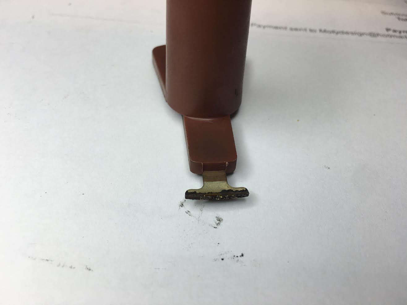

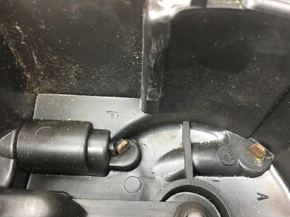

Well finally I think I've got the issue solved. After going component by component in hopes to know exactly what was going on, I think I had more than 1 issue to begin with. Either way I have peace of mind now I have several new components operating correctly. ha. So, thank you for leading in the right direction. I replaced distributor cap and rotor and so far I'm not experiencing the issues any more. All though I haven't seen too much moisture yet..but seeing the condition of cap and rotor terminals it was probably to change anyways. See pictures.
Attachment 4348
Attachment 4349
