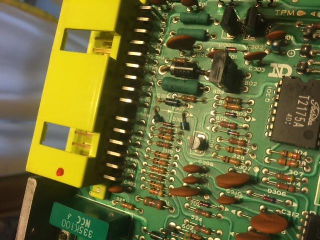

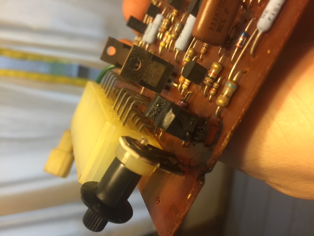

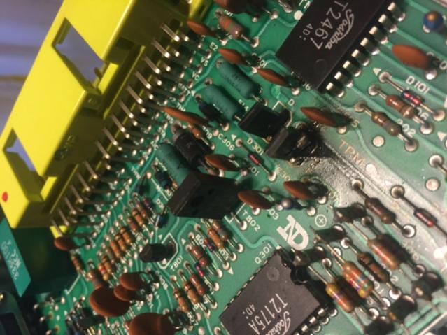

Pulled my RPM relay and it had a blown transistor.
Also pulled my ECU and it also has a blown transistor.
ECU blown transistor accounts for the battery light. Probably a host of other issues as well.
Strangely, there is a broken diode in my ECU that appears to be unrelated to this event. Maybe it has been broken for 31 years?
