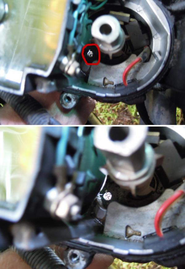

Should there be an open hole in the distributor next to the ignition coil? It seem to be letting in moisture.
Here is a picture:
Attachment 3142

When I first got Red, it had intermittent weird running problems, somewhat similar to your issues.
I found out why when I decided to do a tune-up and found one of the cap mounting screws had been sheared off.
I had to drill out the remainder and re-tap the hole, no issues since.
I do not believe that hole is supposed to be there, but it does look rather round, can't imagine anyone drilling a hole in the dizzy??
I would plug that hole and reassemble, that should solve your drivability issues will then be solved.
I have run into vented caps before (Jag V-12) but they are vented to the intake, not open atmosphere.
It was a one owner van before I bought it a couple years ago and the guy always took it in to reputable mechanics and had receipts for everything. Didn't seem to be any poor DIY work on it or anything to suggest that he would drill a hole into it to try and make a quick fix out of something.
I was hoping to see a diagram of the part to figure out what might have been in that hole
