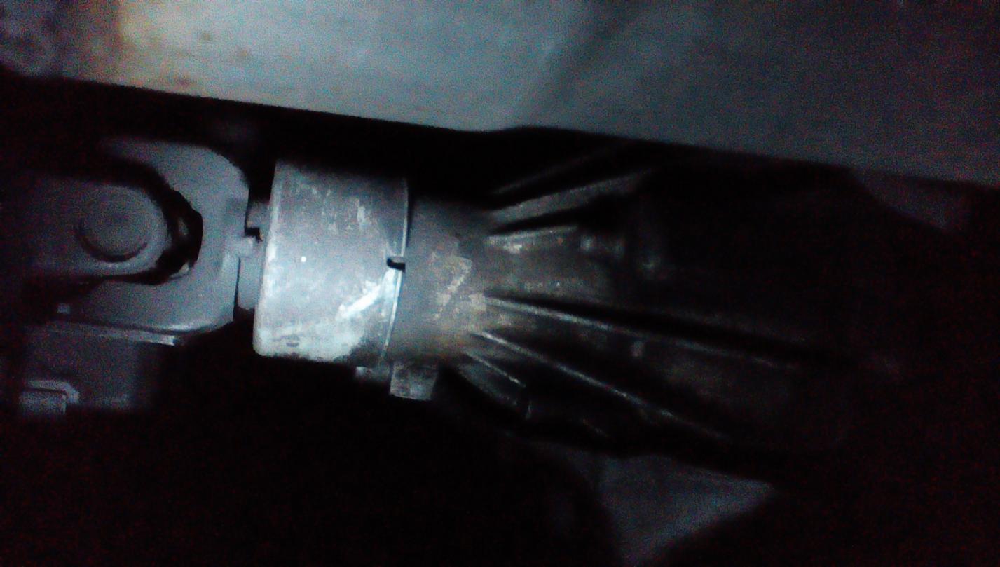

Had a quick question - figured I would post here instead of starting a new thread. I am a new owner of an 88 4wd auto, I have started going through the van to try and get her back in fighting shape. I recently got replacement driveshafts for the front and rear from Powertrain Industries. The rear went in no problem, but the front one seems too short? I feel like the flange on the shaft should go tight where it slides into to the transfer case but there is about 1 1/4" gap. Unfortunately I don't remember how it looked before, so I was hoping someone on the forum could tell me if it is indeed short, or everything is gonna be alright. New shaft measures 37" center of u-joint to center of u-joint. Thanks

I've got approximately 37 1/4" u-joint center to u-joint center and the insertion looks like this:
Attachment 4676
It looks like it has a different length collar.

Thanks originalkwyjibo. I'll see what Powertrain has to say about it.

It looks to me like it's just that protective shield. It's there to protect against dust build-up and sticks & things from touching sensitive parts of the seal area. The original one was long, but the new one is short. It's improper, but likely of no consequence. Still, it seems odd that they cannot build the drive shaft with the correct shield. I'd email those pics to Powertrain Industries and ask if they can do anything about it. Tim
