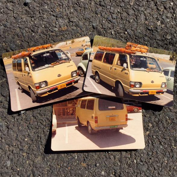

On another note, a friend of mine who's owned a Toyota repair shop in Portland since 1972 (Willamette Boulevard Service Center) just unearthed a set of photos he took in yellowstone in 1981. They're of a HiAce. It was the first Toyota van he'd seen in the states, it had traveled up from Costa Rica. Very cool looking rig.

Wow!!!! That's some serious "Van Love" back from NINETEEN SEVENTY TWO!!!!!:thmbup:

Those pictures are great - the one I'm looking at is the same color and came up from Panama!
