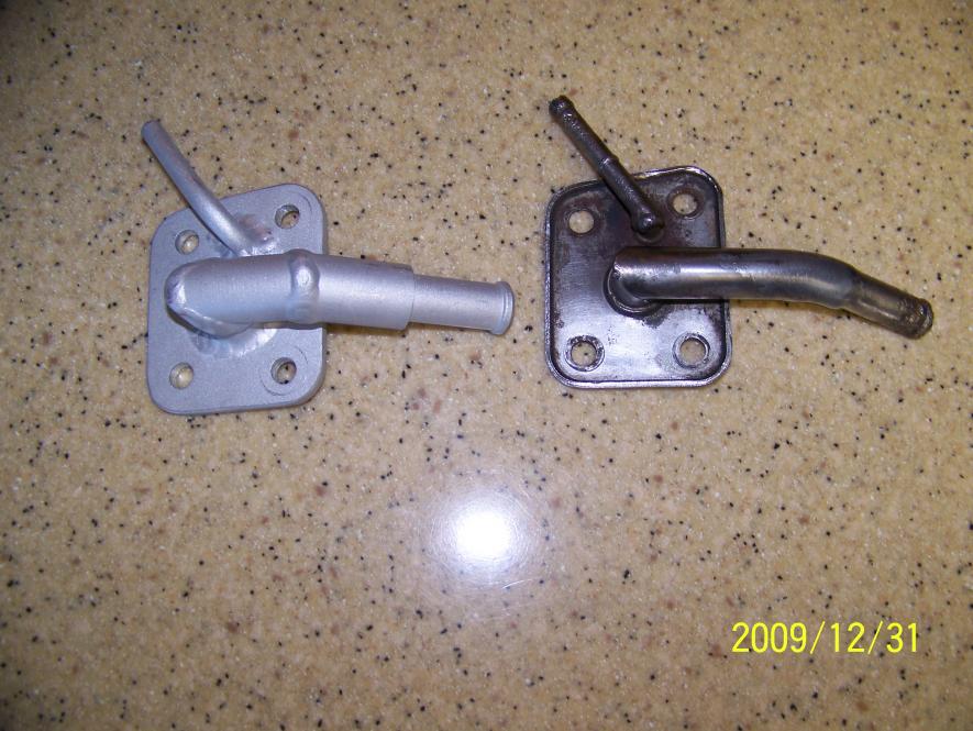

My van had similar symptoms. After getting screwed by incompetent/greedy shops, I ended-up waiting almost a year for a mechanic friend to recover from an on the job shoulder injury. Once he was ready to work on my van I told him to fix anything and everything he thought it needed.
We already knew that the rad was bad, the exhaust manifold was leaking, there were broken sensors and old hoses. He discovered that the hose of death engine plate had tons of tiny pin holes in it (corrosion). He figured that the coolant was slowly oozing out the pinholes then evaporating on the hot engine.
So we got the Yuba City 3 row high efficiency rad, 2 electric cooling fans with programmable on/off temp sensors, new exhaust manifold, had to have the hose of death engine plate outlet thing custom made, new hose of death, new sensors (BVSV, VSV's), checked the fuel injectors, new Toyota OEM head gasket kit, and OEM thermostat. It was a big job but it was worth it.
Now my van runs perfect. All in all I spent nearly 3 years trying to figure out all the problems and finally get them fixed. The hard lesson I learned was going cheap on parts and using unknown/suspect mechanics was just a quick way to become frustrated and broke.
Also I have to mention that my mechanic was referencing this website and was in email contact with Timsrv for advice. Thanks again to Tim and everyone else here for all the great info and support!:thmbup:
Attachment 4679

Also wondering about the pin holes in the HOD cover. my 87 is apart for a new head gasket and the cover id definitely pitted. it seemed to hold air pressure but Im a little leary. Treselhed, is the cover you got available. I figure I should replace it while Im in there.
As always thanks for all your efforts@ TVT
Re: Coolant level dropping, but not showing on pressure test?
I believe that the 2WD and 4wd coolant outlet plates are different. The 4WD plate was N/A when I needed it, but the 2WD version was still available. If you use the search function you might be able to find the part #'s. My mechanic took my old outlet plate to a machininst who used it as a template to custom make a new one out of aluminum.
