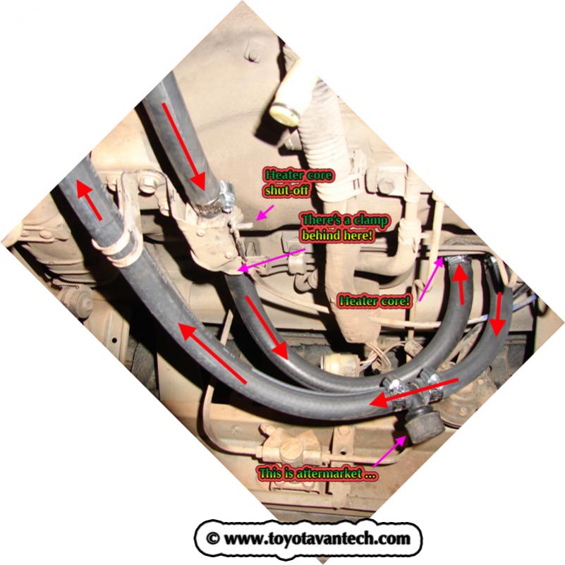

As for flushing the cooling system, Prestone makes some flushing products that work pretty good. You can purchase the Prestone flushing kit at any auto parts store (even Walmart should have it). The kit consists of several tees and an adapter for a garden hose. For the van you want the 5/8" tee (discard the rest). The best place to put the tee is under the front of the van. Just lay down under there and find the heater hoses. Cut the line and mount similar to the way Llamavan mounted in the picture below. She has it labeled "This is aftermarket"

After the coolant is drained and the tee is installed, attach one of those shut-off valves (for your garden hose) and the garden hose to the van via the tee. Open your radiator drain and start the water flow by partially opening the garden hose valve. Adjust the flow of the garden hose to exceed the drain rate. Watch the coolant fill port on your engine. When it's about to overflow, adjust the flow of the garden hose to match the rate of the radiator drain. Now start your engine and open your heater controls to full heat. While monitoring water level, let the van run like that for at least 15 minutes or until the water in the system looks clean (I usually let it flush for about 1/2 hr). If your system is really dirty, after you're done flushing, put in some of that Prestone Super Flush stuff (a liquid cleaning agent), run the engine for a while (follow product directions), then drain and flush again like you did the 1st time. After it's all clean, drain and fill. There's a drain plug on the side of the engine block that should be opened too (in a bad spot under the exhaust manifold). I use a 14mm socket and a short extension to reach it. After all the water is out close all the drains, put the cap (included in your flushing kit) on your flushing tee, replace the antifreeze and you're done. Due to the acidity and/or sediments in tap water, I recommend using the premixed antifreeze. If you decide to use the concentrated stuff, use distilled water. A good ratio of antifreeze to water is about 50/50 (that's a freeze protection down to -34°F). Have fun. Tim
Actually, Skyler came to me like that and just I kept it that way when I replaced hoses. A couple of years later I tracked a coolant leak to that spot. Unlike joints between rubber hose and metal, the hose never "bonded" with the plastic and it was oozing coolant. No amount of tightening would keep the leak at bay even though it wasn't leaking for quite awhile. The tee cap was not in very good shape, either. I ended up replacing that section of hose with continuous rubber again. So if you do this (IMO worthwhile for doing the flush), keep that in mind.
