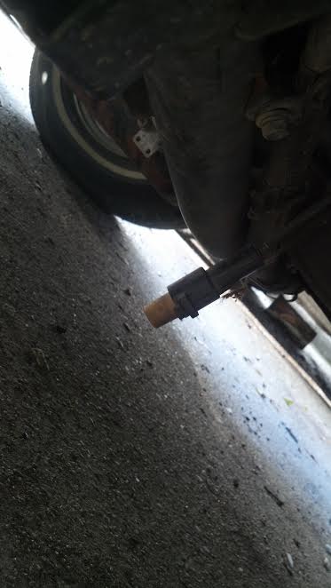

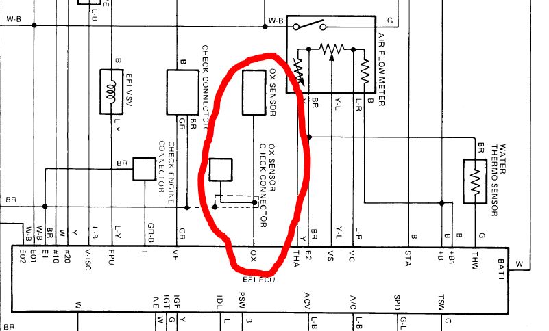

Is the wire hanging and not connected to the 02 sensor, or is the wire connected to the 02 sensor and not connected to the harness? When looking at the wiring diagram the sensor wire runs back to the harness which runs back to the ECU. The harness branch is close to the air meter and mine had a brittle grey vinyl tube covering the 02 sensor wire. I just did this repair on my 86. When I bought the sensor, I thought the parts store sold me the wrong one. The one they supplied had male threads on the sensor. It turns out my van is registered as an 86 but actually has the 87 build as far as the exhaust, so it takes the single mesh shielded wire 02 sensor with the oval flange, gasket and two nuts. Also the previous owner or technician had broken the connector on the 02 harness branch, so a splice, solder, silicone waterproofing and electrical tape connection was made to complete the branch to 02 sensor circuit. An important thing to know which is not shown in the diagram is that the mesh shield wire needs to be grounded in order for the 02 sensor to complete the circuit. When I repaired mine, I discovered the mesh shield wire was corroded and not making a good ground, causing a check engine code 05 (opencircuit in 02 sensor). I had to strip the circuit back about 6-8 inches to find good mesh shield wire. I soldered a new circuit to this and grounded it on the intake manifold near the air meter, where some other circuits are factory grounded with terminals. This solved the issue and the light has stayed off and the van runs much better. I hope this info helps.

The other side of the connector is near the air filter box, toward the steering wheel on the engine side. It will be the only one that fits the 02 sensor, sporting a single conductor and a plastic tab to help glide it in.

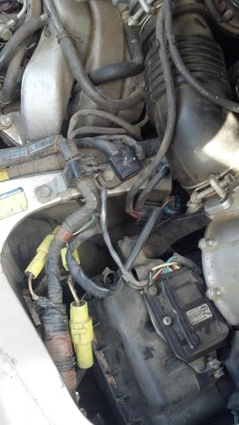

Attachment 4807 Attachment 4806
im just not seeing anything where it would plug in. it seems like itd be very obvious, but nothing, and near the airbox, im assuming you mean right in this area right?

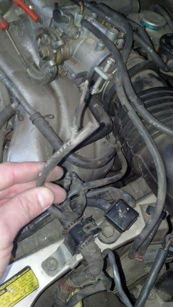

if anyone is able to show me a picture of where the o2 sensor plugs into the electrical, i would be totally stoked. sorry im new to this van, love the thing just trying to figure out everything! thank you so much! also i found this cut wire (coming out of split casing) that was hanging down toward where the o2 sensor is. maybe somebody cut off the old one, never spliced on new one? i dont know. wire looks to be about the same size as the one connected to the o2 sensor. Attachment 4809

It looks like you are holding the correct wire in your last picture because there is no connector attached The 02 sensors from 84-87 that were single wire commonly broke off right at the plug.

The picture of the hanging wire looks like the mating conn for the 02 sensor? This circuit should just run up into the branch on the harness and go back to the ecu. The junction is right in that area by the airflow meter. Follow the hanging conn circuit and see if it is broken? It might belong to the branch you pictured with the YAZAKI stamp on it? If so make sure that when you repair it that you also pay attention to that shield wire I noted in my first reply. Please see the attached pic of what the factory spec connector looks like on my van.

ok i figured out whats going on. the male end of the connector, broke off at the wire, and was inside the female end of the connector that is on the opposite side of the wire of the sensor itself. i guess i look for a male end connector peice at the parts store and splice it on. thats what its seeming like...
