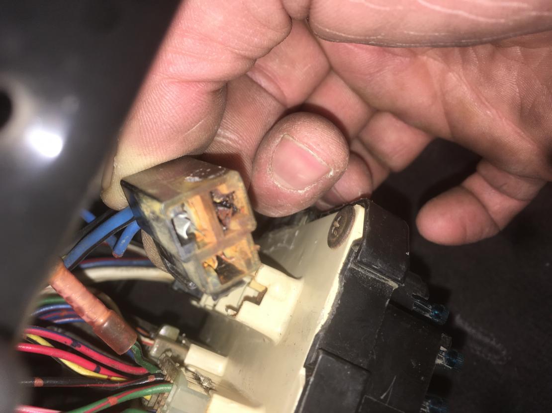

I would inspect the wiring harness that connects the wiper and turn signals that runs under the steering column there is a large connection that has been known to burn up from resistance due to a poor connection. Since the wipers and turn signals don't work and the fuses are not blown this could be the first place to look by removing the steering column covers.

Attachment 4935
Found the culprit!
Shheesh... on the back of the fuse box.. The black and yellow wire in particular. cleaned it all up and pinched the connectors back together

Got the TV started and brought it directly to a shop.
Although the shop could not find an OEM or AM harness, they found an alternative harness, spliced wires and got the wiring back in proper order. They charged me for one hour of labor.
