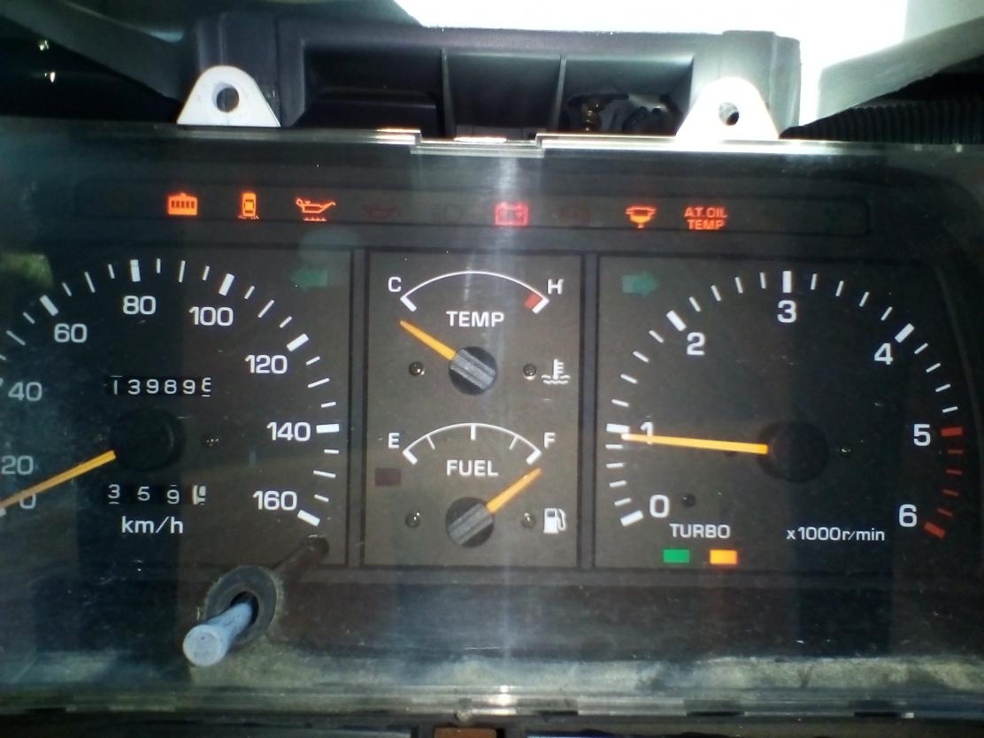

The Christmas Dashboard:
Attachment 4968

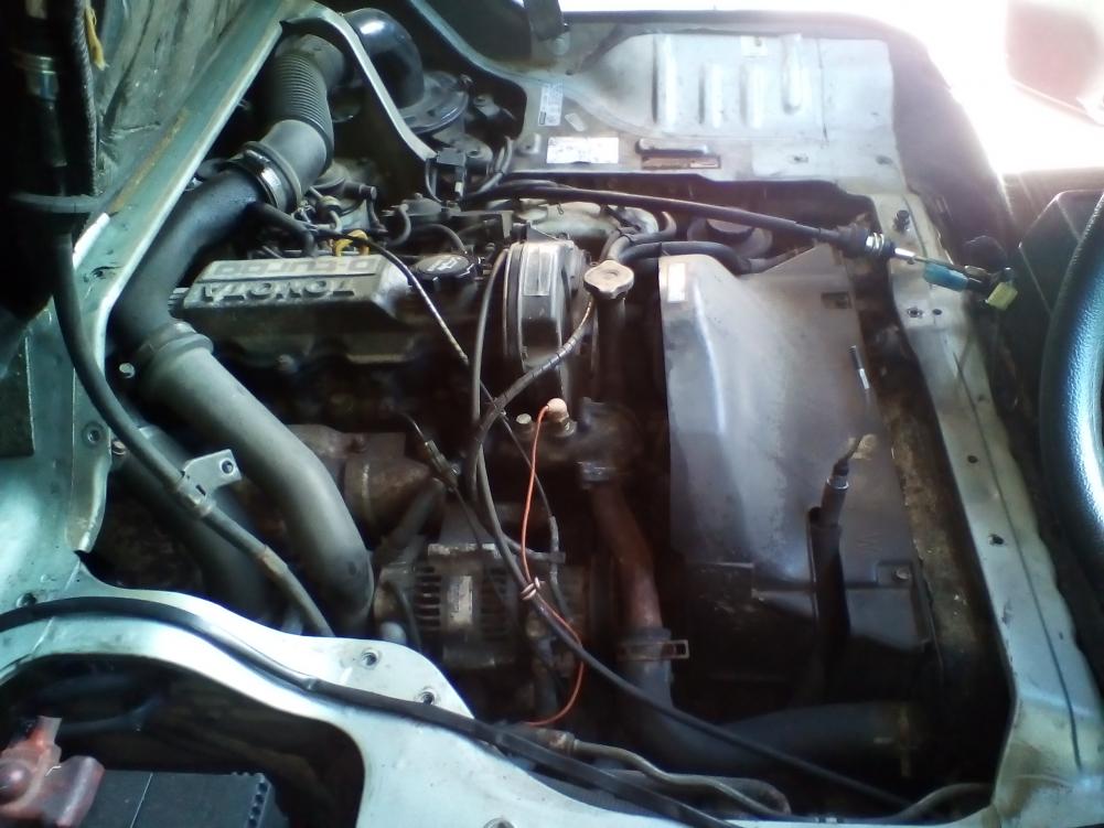

The engine:
Attachment 4969

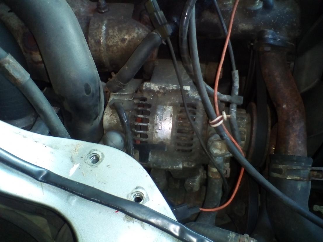

The alternator, which is special: it is also the vacuum pump for the brakes:
Attachment 4970

That alternator is looking pretty crusty. If outside of your skill set, I would find someone to test the alternator for you either in the van or removed. Also it would be better to post this in one of the alternator/Christmas dash threads so all this info stays in one place. Maybe a moderator could move it.
Re: Yet Another Christmas Dashboard...
Hi originalkwyjibo,
Thank you for your answer, you were right! I solved the problem two days ago, and I was going to write the solution here soon.
It was indeed the alternator, the rotor was dead, I removed it (not easy with the air and oil pipes of the vacuum pump!) and luckily find a new one in a wrecker.
