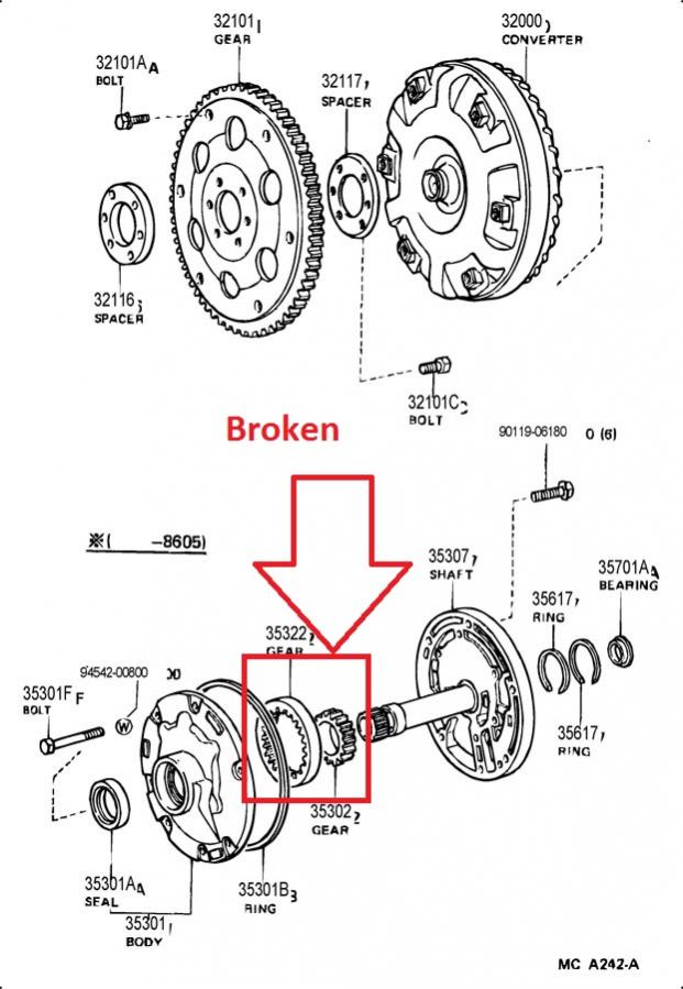

I tried to bolt the engine on the tranny with the torque converter already on the engine, and the torque converter broke the gears inside the pump housing :wall:
I did a little more research online and found the internal parts to replace it myself, for a pretty reasonable price. http://parts.germaintoyotaofnaples.c...wd=&origin=pla
I've never gotten into transmissions before, but would consider myself pretty knowledgeable mechanically (besides this little incident). I believe now I just need some assistance in figuring out how to remove the pump housing plate so I can get into the transmission to find out what is wrong.
I've attached pictures of what I believe is broken from looking in and poking around.

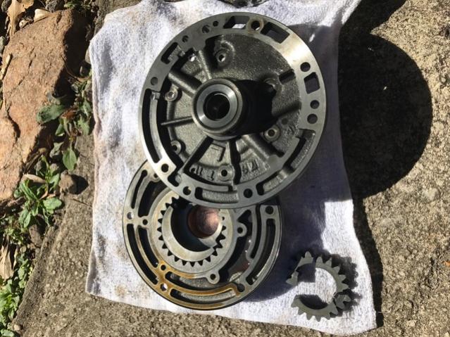

To add to the knowledge base here... I figured out how to remove the pump without the $317 SST tool!
Here are the steps I took:
- Wrap input shaft in shop rag
- C-Clamp on input shaft
- Attach one side of ratchet strap to C-Clamp and the other side to front sway bar...then crank!
Also, here is the picture of the damage...hopefully it will teach me and everyone here to research before trying something the first time! :silvervan:
Attachment 4991
