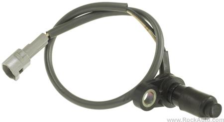

I don't know the exact location of that Speed Sensor and from that picture it does seem like it could be anywhere on the driver side of the van. Here's a picture from rockauto that shows what it probably looks like, maybe it'll help with locating the VSS:

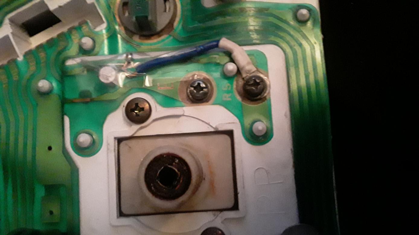

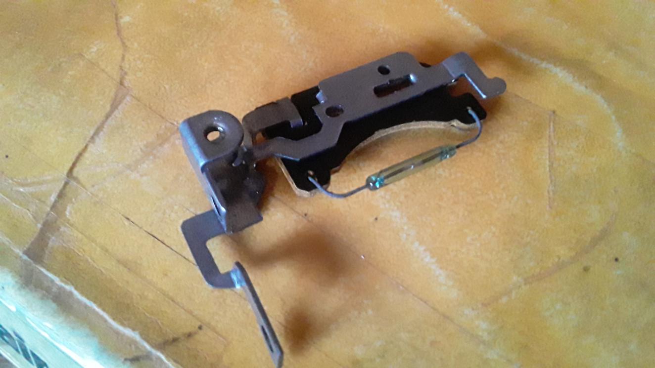

Attachment 10785Attachment 10786
top pic is the main part of the speed sensor, it lives on the speedometer in the cluster and connects to 'spg' and 'rsw' on the circuit board. i just swapped my cluster and the rsw connection was blown like a fuse, i made a repair(bottom pic) but didnt test the speed sensor(continuity at 4 points per revolution of speedo cable), resulting in no cruise control, van seemed to drive fine otherwise..after examining the speedo i was happy to realize i could remove the sensor without disassembling or removing the speedo needle by just removing 2 screws. i replaced with one from a parts cluster(2wd auto, no cruise) and it now works! not sure how, its like a glass fuse...
so...according to fsm this signal is used for cruise control and auto 4x4s which i understand, but it also gets fed to the main ecu...im curious if the efi systems use this signal and what symptoms it could cause if it were broken?
