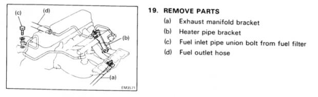

You'll also want to remove the exhaust connections into the manifold. Remove the bracket first:
Attachment 5348
Then remove the bolts (not my van but a good photo) you can see the two bolts and theres a third obscured by the pipe. The bracket is on the right edge of the photo. This also gives a good view of the EGR pipe where it connects and the o2 sensor (this is a 2wd van).
These bolts are likely to be extremely frozen and difficult. I rounded one bolt, and twisted the head off the stud on the other, but fortunately with some luck was able to get them all removed and the pipes separated without cutting anything or having to go buy an extractor set. Just make sure you soak them real good for several days with PB blaster if you're worried about this part.
Attachment 5349

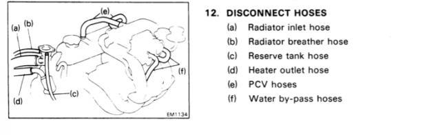

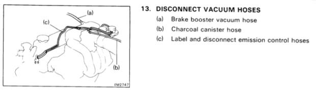

3. Disconnect hoses and electrical
Mark (or take a photo) and disconnect all hoses and electrical connections (if you haven't done so already from removing the throttle body). The factory service manual covers this well on page EM-10 and EM-11. I found the manual very lacking in regards to bolts and locations, but it covers this part very well thankfully. Here are photos for reference:
Attachment 5355
Attachment 5356
Attachment 5357
Attachment 5358
the hoses in the last photo are the "hoses of death" (there is also one on the underside of the intake) so I plan on replacing those while everything is apart. They seem to be in ok shape but since I have no idea how old the are its a must do with all this working room. I actually think I should be able to replace them without cutting an access port since I have slender hands, but we'll see.

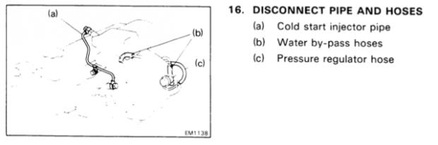

this is the only step the FSM gives you. not very helpful. but here it is:
Attachment 5345

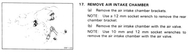

The trickiest part is these hidden bolts on the backside of the intake. Fortunately I stopped and documented this part well, lol.
http://i.imgur.com/amfl4jc.jpg?1
Remove (a) and (b) from the FSM. I didn't get photos but they're easy to see.
Attachment 5346
you should be able to wiggle the upper intake now and feel it loosen and pop off. if you wiggle it and its not rocking off fairly easily you'll have to check and make sure you didn't miss any bolts somewhere.

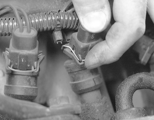

Ok - now unplug all the fuel injectors. pry off the little metal tension clips. you had to remove these when you disconnected the TPS and other EFI connectors earlier, but I used a little craftsman pick set which are pieces of crap, but anything similar (even a flat head screwdriver) will work. Once you pull those retaining clips off they'll unplug easily. I didn't get a photo but its almost identical to this (so you get the idea):
Attachment 5347

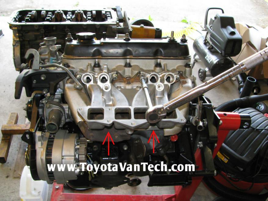

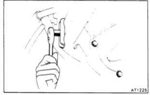

Now, there are two hidden nuts underneath that you can only reach with the perfect length socket wrench extension. This part (especially the the front-most bolt) for me was an hour long battle at least. You have to be underneath for this. my stupid socket kept popping off up in there and then I'd have to spend 10 mins fishing it out each time. then when I finally got it I could not get it to budge so I had to retry with a breaker bar, which BARELY fit. I had to stick the extension/socket up in there first and then connect the wrench once it was in because the wrench+extension+socket was too long. you'll have to find just the right jankey combo of adapters/extenders/shallow/deep socket to get this to work haha. heres a photo from another thread by Tim that shows how to remove those lower two bolts:
from tim: "On the under side of the intake manifold there are 2 channels. One between the chambers #1 & #2 & the other between chambers #3 & #4. Anyhow these channels are like tunnels & just big enough to fit a socket into. With the correct length extension(s) you can get those two nuts off pretty easily. Here's a picture for reference:"
Attachment 5354
you should be able to wiggle the lower intake now and feel it loosen and pop off. if you wiggle it and its not rocking off fairly easily you'll have to check and make sure you didn't miss any bolts somewhere.

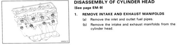

5. Finish unbolting the exhaust manifold
There is a 3-piece heat shield with 6 small 10mm nuts over the manifold you'll want to remove. My phone died right at this point so I don't have any photos, sorry! The heat shield is very easy to see and access though so you should have no problem with this.
Once you pop those off theres only 2 nuts you need to remove to take off the exhaust manifold. you'll see a nut on the lower left and lower right of the manifold. I was able to take them both off from above the engine easily. here is a photo from the hose of death thread I linked to earlier that shows the bolt pattern of the exhaust surface:
Attachment 5351
or this image from the service manual which shows the location of the 8 bolts:
Attachment 5352

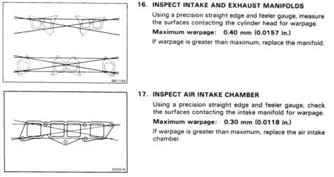

The manual actually specifies to test the mounting surface for flatness to ensure your manifold isn't warped (if it is you'll have to replace it):
Attachment 5353
