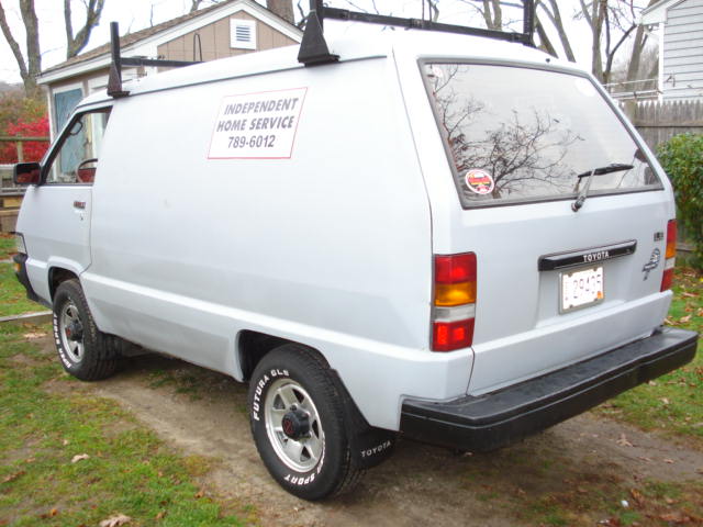

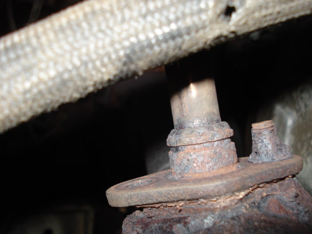

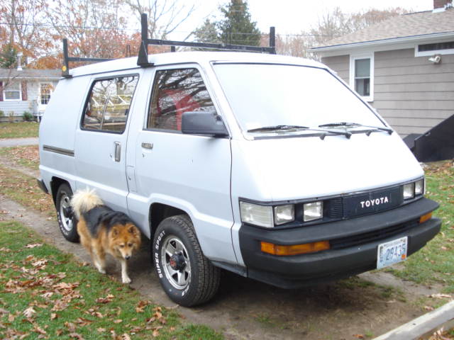

that was cool news!! i went ahead and did a code check as described and it appears that all is well with the van. the only flashing that i got was a flash every 3 or so seconds, i believe that means no problem found? but im still gonna replace the o2 sensor. i though i,d post a pic of the ugliest o2 sensor on earth! also just a few pics of my van. Attachment 437Attachment 438Attachment 439

Van looks great.
I suspect those roof racks may impact your mileage to some degree.

ok vanners just a quick up date . throttle body cleaned- egr valve cleaned- new tps installed and now this evening the o2 sensor installed. the ols o2 was so badly in the system(rusted) that the plan of attack was to cut the old out and just weld a new pipe in. the low fuel light just came on and if my math is correct i,m seeing 21 mpg around the town before the o2 was installed!!!!!! so it will get mo better. i can only say that if yer rigg aint gettin it (poor performance) go ahead n do these simple tricks. i was sooo scat to do this repaid but, with the help of you guys it was so easy. at the moment i,m a happy vanner. just go ahead n do it lots of help here.
