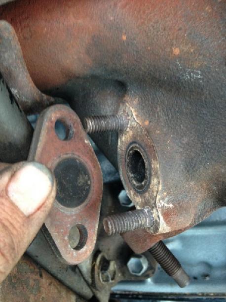

Hey y'all is the supposed to be a crush washer or gasket in this extra exhaust port?
Attachment 6432
I wish I never took it off. :doh:
