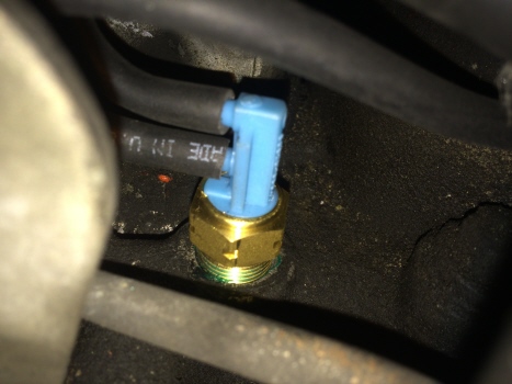

Guinea pig I shall be ... I placed the order,but, holiday will delay shipping ... When I take out the original I'll do a photo of both parts together for everyone, and, I'll give info on the install and the function of it. (I can test its opening temperature too, before I install it).

Attachment 6229Okay... here's how it went. The new part tested out perfectly in a mug of warm water -- it was closed when it was cold and had wide open air-flow when I blew through it after it warmed up (to about 105-110 degrees on my thermometer), so, that looked good. Next, the physical comparison... same thread pitch and diameter as the original part. Next, the install and function --- I sliced open the side of a 19mm 6-point socket just as Tim shows in another thread. The new part (the"05047" valve) threaded into the hole properly and came to a pretty firm "stop" with the ports of the BVSV facing forward as they should. The only thing that sketched me out a little bit was the depth of the installed BVSV... it seemed to only go in about 1/2 or 2/3 of the threads when it stopped... I think the threads are tapered and they widen as they screw in to form a seal... My concern was that it would leak. After quite a few miles I can report no problemo. Also, I tried to blow through the installed valve on the van when cold (nope), and again after I had driven somewhere and the van was warm (yup, valve wide open)...
so, I wouldn't be afraid to tell someone to go ahead and use the "05047" valve to save money over the "05017" valve.
