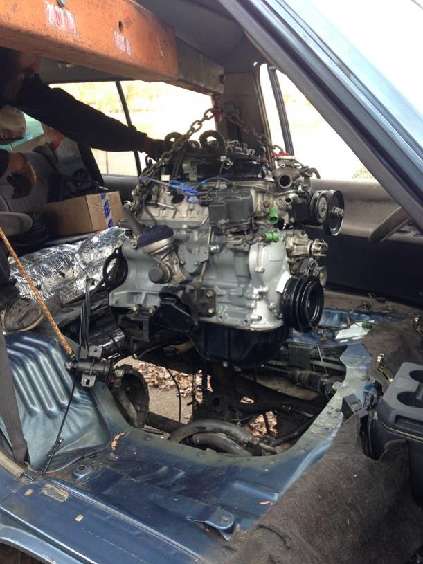

It took me about 2 days to pull the engine out of the passenger door. I took the whole door off, but that might not have been necessary. I was a total dummy and didnt know about disconnecting my torque converter from the drive plate beforehand, so I just pulled the whole converter with my engine, which made it much harder to maneuver, but still do-able. Another day to strip it down to the "long block". There was about a 2-week turnaround time with my machinist (mostly just waiting on parts in the mail) and then it took me about 2-3 weeks to re-assemble the do-dads on the engine and put it all back in. That might sound like a long time, but it's all the little holdups you run into like "hmm actually, I wanna do rust control / paint that coolant pipe nipple before I reassemble this" or "I gotta run to the store to find one little crush washer" that take up so much time. If you pro-actively do a lot of this stuff beforehand while the block's in the shop, you could move through it a lot faster.

I lost my photos of pulling it, but here's the gratuitous dropping-it-in shot
Attachment 6460
