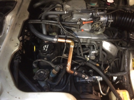

radiator cap ---maybe a dumb question ?? but, here's the story ...
- 1987 2wd runs like a Swiss watch
- have zero cooling system issues/ problems/ leaks, or anything...including today, idling 10 minutes in 95 degree heat...
the radiator cap is from my "burned-down" ex-1986 van
it works perfectly
it's ugly and tarnished, however, from the fire
Can I use a " 1.0" nippondenso cap from my Sienna in place or the " 0.9" ND cap that is on there now ???
it's been in use in the Sienna for 15 years, so, I assume it's a bit weaker than its "new" rating...
am I asking for trouble ? will there be too much pressure ? or, will it be about equal to my "2-year old 0.9 cap" that I've had on there now ?

There are two different style caps. If turned upside down and compared side by side it will be plainly obvious if they are different. 0.9 bar is about 13 psi. 1.0 bar is about 14.5 psi. But why not just buy a new cap? List price is less than $20 from Toyota.

we're selling the 2003 Sienna and I want to swipe it's pretty, shiney, "yellow-stickered" radiator cap and swap it for my ugly one ...
Attachment 7179
... for no "out-of-pocket"...
